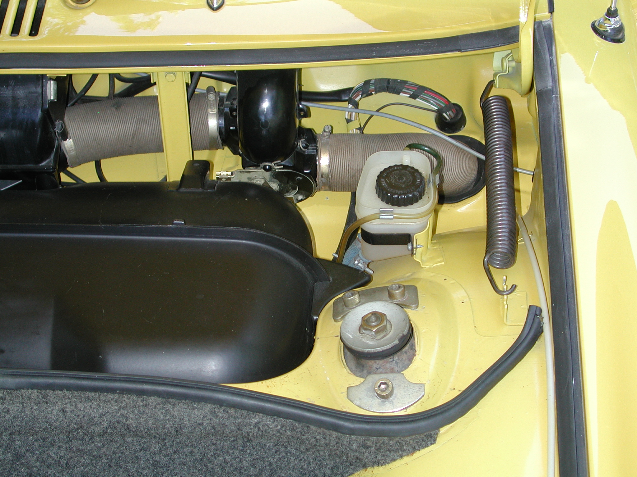

The factory manual and PET show an overflow tube from the brake reservoir. None of my 914s had them so I've never seen one. Did they really exist? If so, how were they attached? I see the vent on my reservoir but no place to attach a tube. I can't see anyplace that looks like something broke off either. (IMG:style_emoticons/default/confused24.gif)

brake fluid reservoir vent tube installation on a 70/4...….

mepstein I think the early cars had the overflow tube and t... Feb 7 2019, 08:37 PM

I believe only the early cars (end of ... Feb 7 2019, 09:22 PM

I believe it was also used on the early 9... Feb 8 2019, 02:02 AM

914Sixer Rory,
Try some fuel line for model airplane engine... Feb 8 2019, 07:22 AM
Chi-town I have two early reservoirs with the drain tubes Feb 8 2019, 09:00 AM
bbrock Thanks guys. Good to know and at least not an ite... Feb 8 2019, 09:07 AM

theer My '72 has a vent tube, too.

isdyl Yes me too! I used a pressure bleed system rec... Feb 9 2019, 05:10 PM

rgalla9146 Follow up on this thread.
Be sure to use the c... Feb 21 2019, 11:34 AM
mgphoto My ‘72 built late May doesn’t have the vent ho... Feb 21 2019, 01:56 PM
913B To source that tube you can go to the local pet st... Feb 21 2019, 08:17 PM![]() ![]() |
