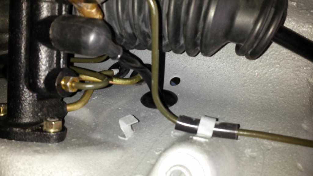

Thanks guys. Good to know and at least not an item I need to worry about for my car. Nest question, is the hole and clip above and below the brake switch wire grommet in the pic below for the overflow tube that I don't have? Can't think what else those would be for. If so, I think I'll find a rubber plug for that hole.
Thanks again. |

1970 Neun vierzehn brake fluid reservoir vent tube installation on a ... Feb 8 2019, 07:46 AM
Chi-town I have two early reservoirs with the drain tubes Feb 8 2019, 09:00 AM
