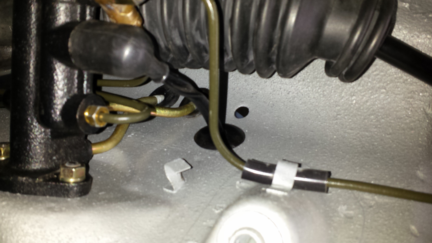

Thanks guys. Good to know and at least not an item I need to worry about for my car. Nest question, is the hole and clip above and below the brake switch wire grommet in the pic below for the overflow tube that I don't have? Can't think what else those would be for. If so, I think I'll find a rubber plug for that hole.

Thanks guys. Good to know and at least not an item I need to worry about for my car. Nest question, is the hole and clip above and below the brake switch wire grommet in the pic below for the overflow tube that I don't have? Can't think what else those would be for. If so, I think I'll find a rubber plug for that hole. Thanks again. Yes, the hole is for the overflow tube and the tab below is to secure the tube. It should extend past the gravel shield. PS beautiful work. Let us see the rest of the car. OOPS !...just found your 47 page thread. Beautiful. |
