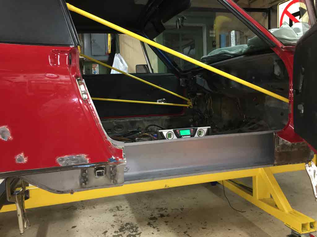

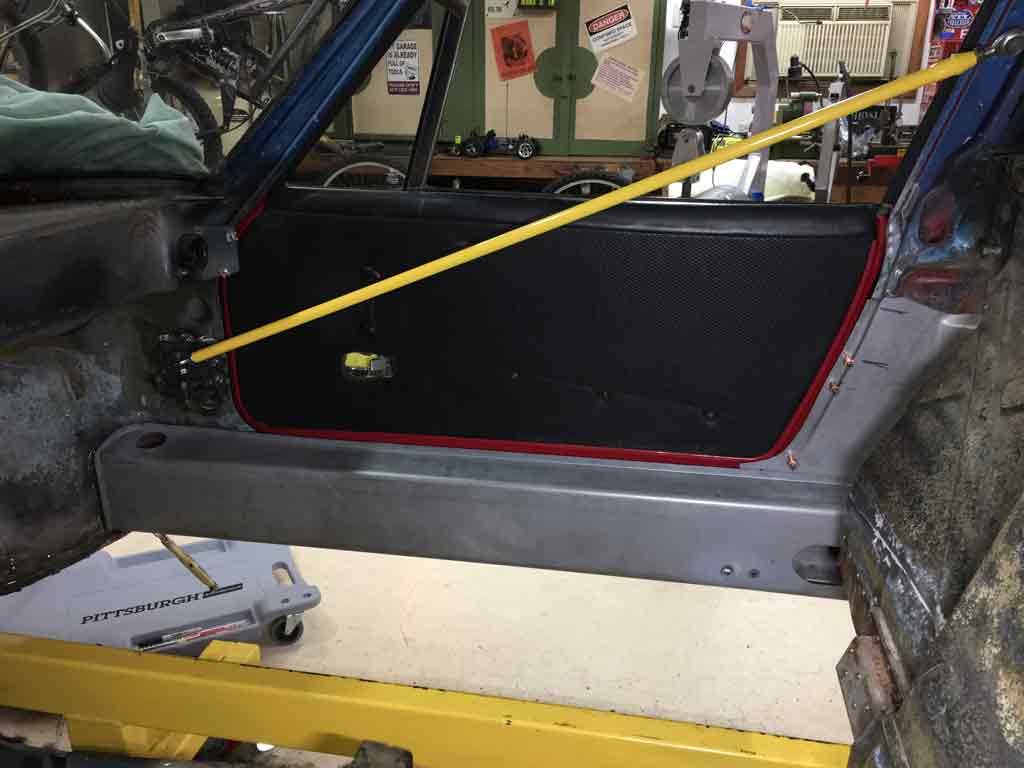

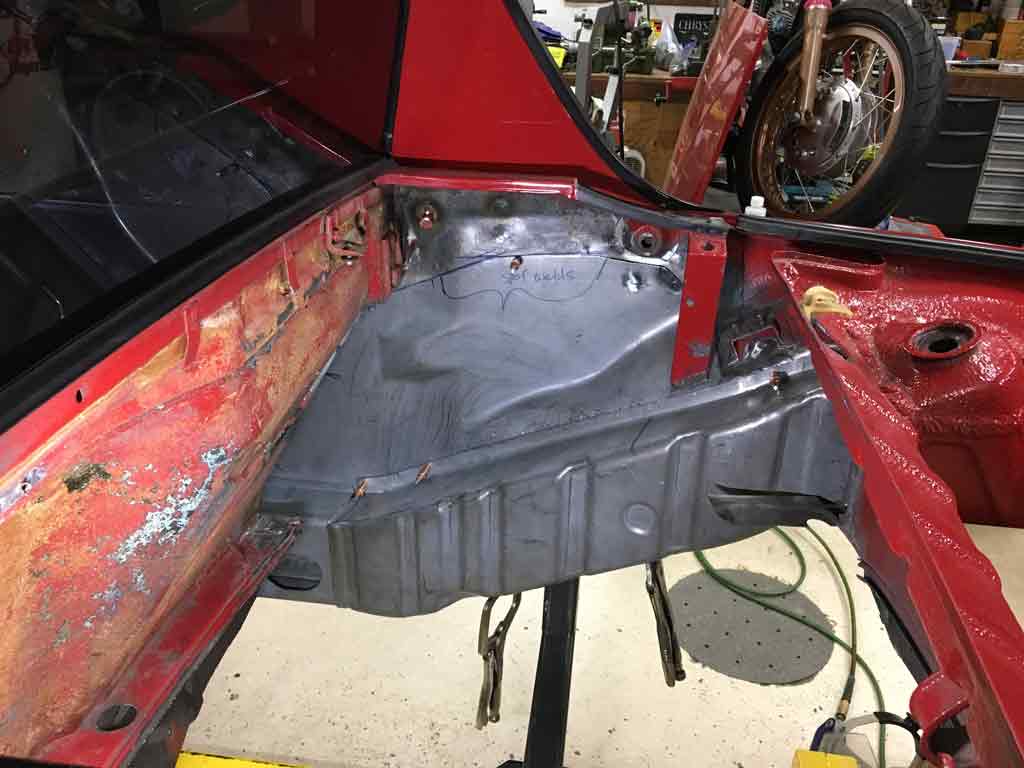

Back to work. Last couple of weekends have been limited work due to other priorities and some ridiculously cold weather.
Back to mocking up pieces to tweak fits. First order of business was to get the inner frame mated to the outer wheel house and to the fit up the connection at the rear trunk.
In my case I found that the outer house sheet metal which as a doubler welded to it was causing the inner to sit too high. I did some creative reforming with a hammer and dolly and got it down to the point where the angle of the two frame rails is within 1 degree of each other.
I then started to mock up the inner longitudinal. This one is a bit surprising that the sheetmetal overlap between the inner frame rail in the engine compartment only overlaps the inner longitudinal by about 1/4". That just isn't going to do. That joint will be too weak and it's right at a highly stressed location.
I'm considering welding in a good 6" of overlap and then installing the whole inner longitudinal + the engine compartment inner all as 1 big piece.
Overall, I'm pretty happy to see something roughly resembling a "frame" back under the car even if it's only a mock up. It will likely be a while before I can weld. I have quite a bit of pin hole rust up in the front wheel wheels that needs to be fixed before I weld in structure.
Question: Does anyone know why the AA inner longitudinal has two seat belt bolts? My driver side and the cutout part only had one. I can't see the point in this. I'm likely to cut the 2nd out and fill the hole so that I only have one like the original.
