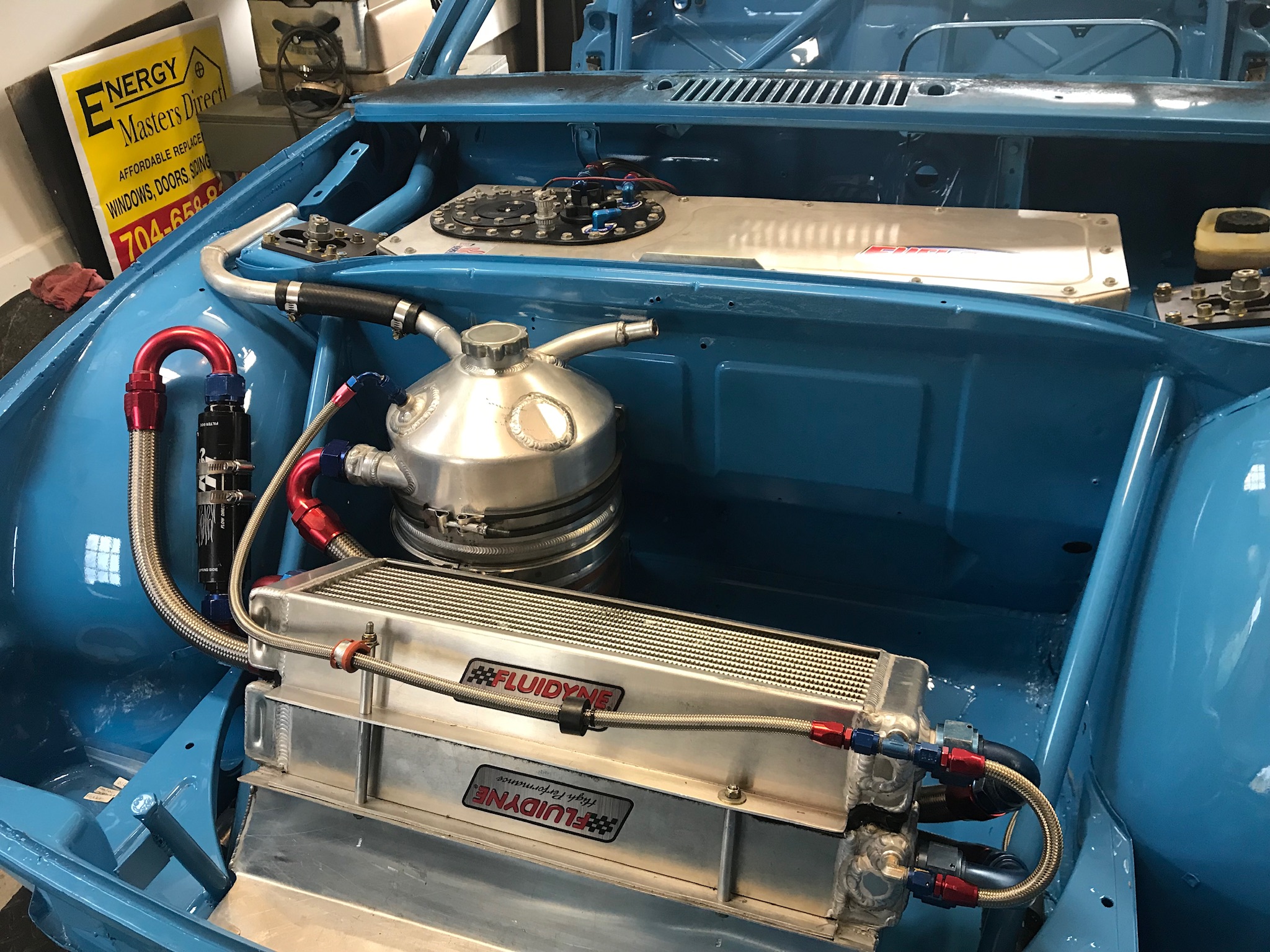

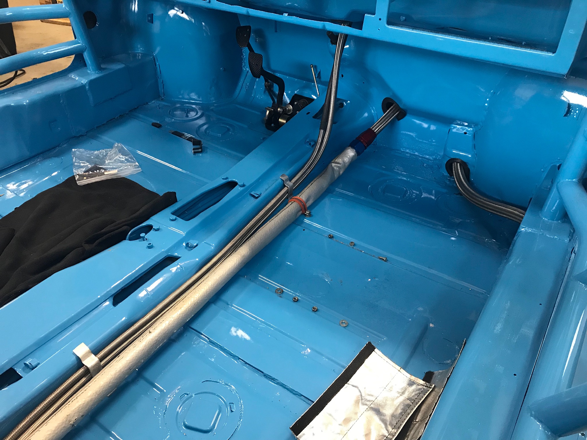

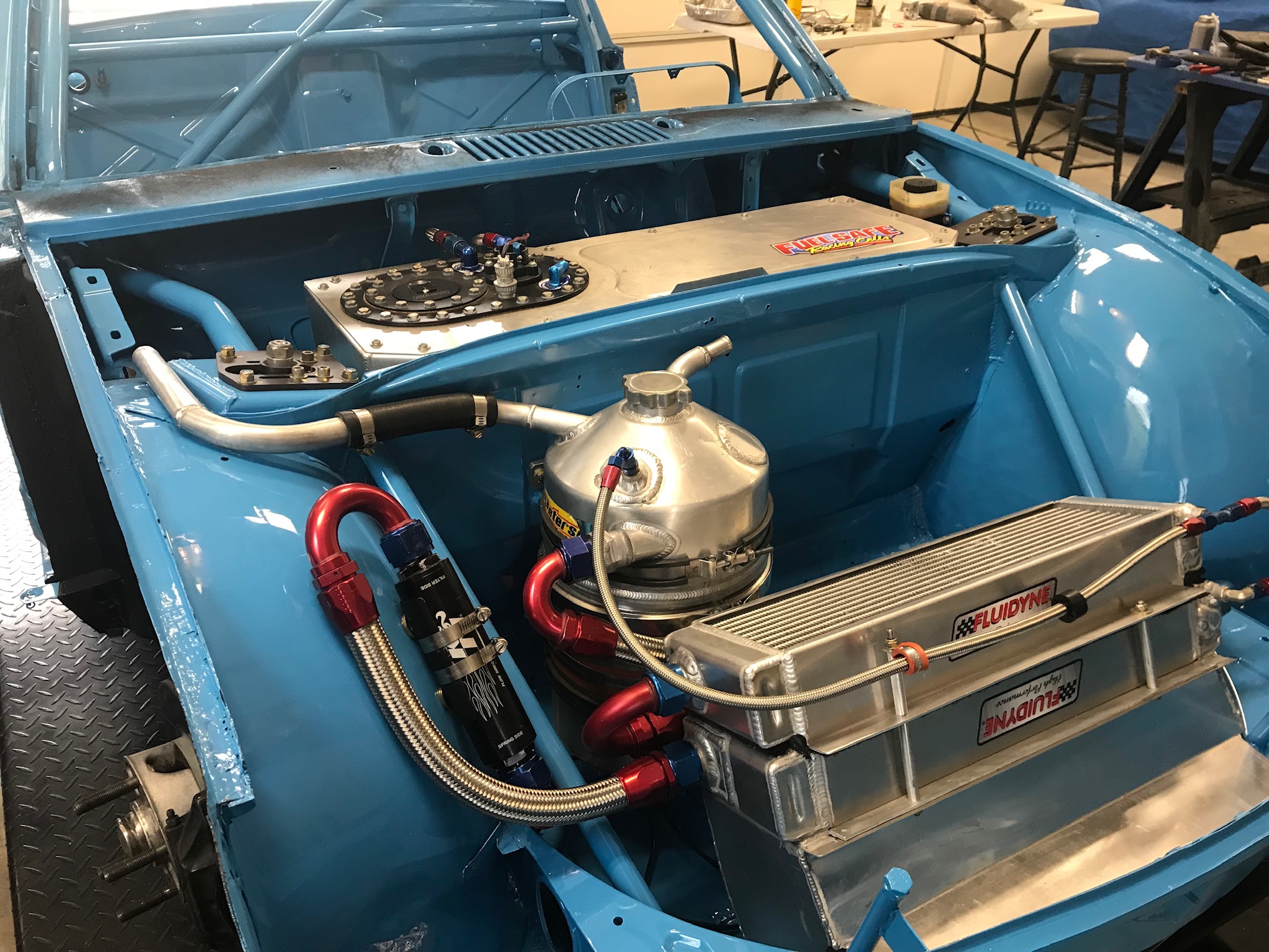

Few progress pictures: these are from last Friday. Lots more was done over the weekend including work on the dash, all the oil lines, fuel lines and trans cooler pump and lines installed and tightened. But everything was a mess and I wasn’t going to clean it up to take pictures, and now it’s up on the lift with the GT3 under it and it was sleeting and freezing rain today, so it’ll have to wait until it clears up...

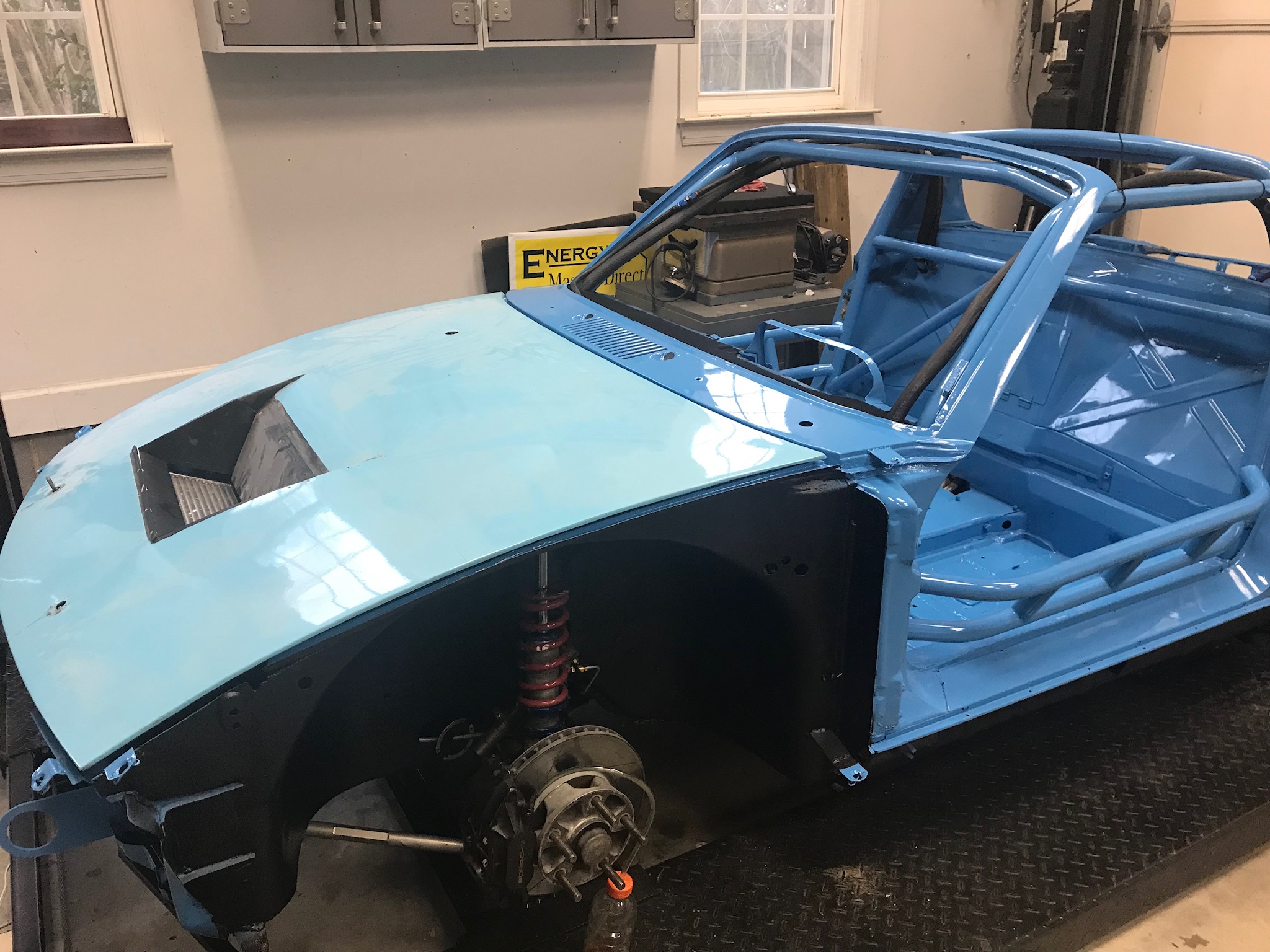

This picture is to illustrate the contrast from the original Olympic Blue to the current Labuan blue. We needed to fit the hood on to measure a few things with the cooler and fuel cell.
