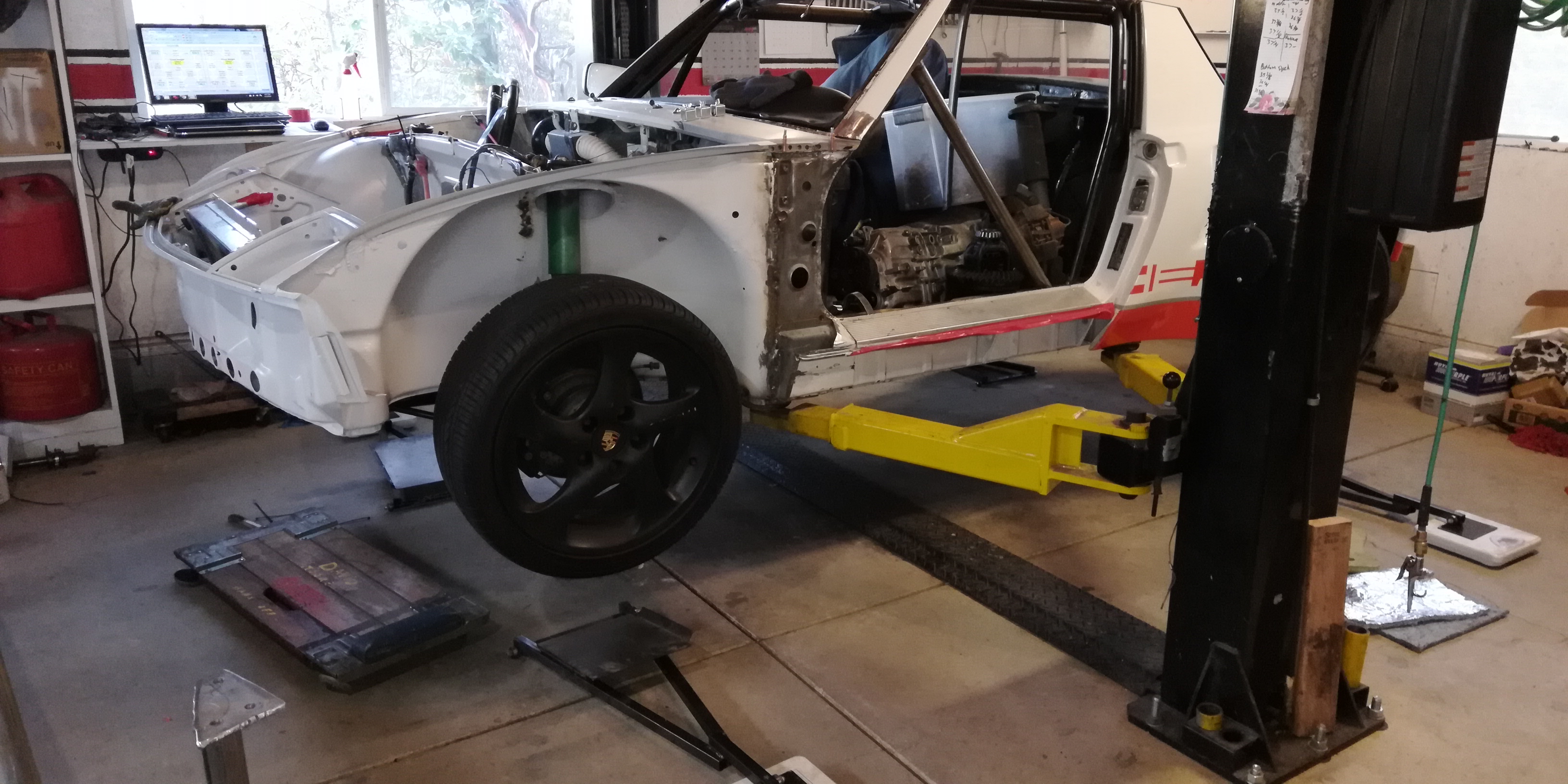

When I turned 50 I petitioned for a rack. I chose a full lift 2 post rack from a car show special price. It was the best thing I could have done to keep wrenching. I use it constantly. I've had my 914 on the rack for the last 8 months. It's gone up and down maybe inchs at a time to get it to the exact best height to make it the easiest on this old body. i can't even raise it all the way up because I have a 9 ft ceiling. But I use rolling seats. It works for me. 20+ times a day I'm adjusting the height. It's a lifesaver.

Nice Shop - I have shop envy.
