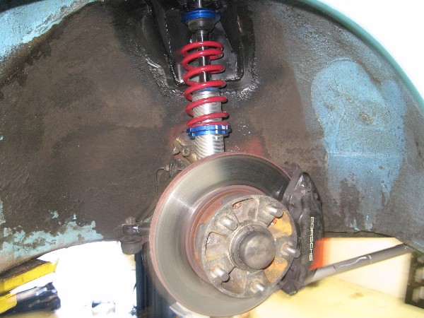

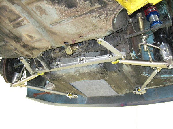

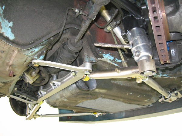

QUOTE(Amenson @ Feb 20 2019, 07:35 PM) *
Looking great. (IMG:style_emoticons/default/first.gif)
Would you mind posting some pictures of your front suspension setup.
Sure. I should be working on it tonight and this weekend and will take some current ones.
Here are a few old ones from years ago, but the set up is basically the same.

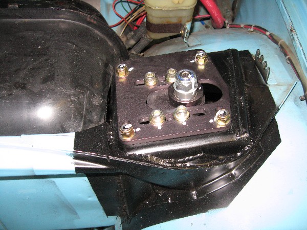

Amenson   Car is looking great. Whose camber boxes are on t...   Feb 2 2019, 11:24 AM
naro914   Car is looking great. Whose camber boxes are on ...   Feb 2 2019, 12:48 PM
