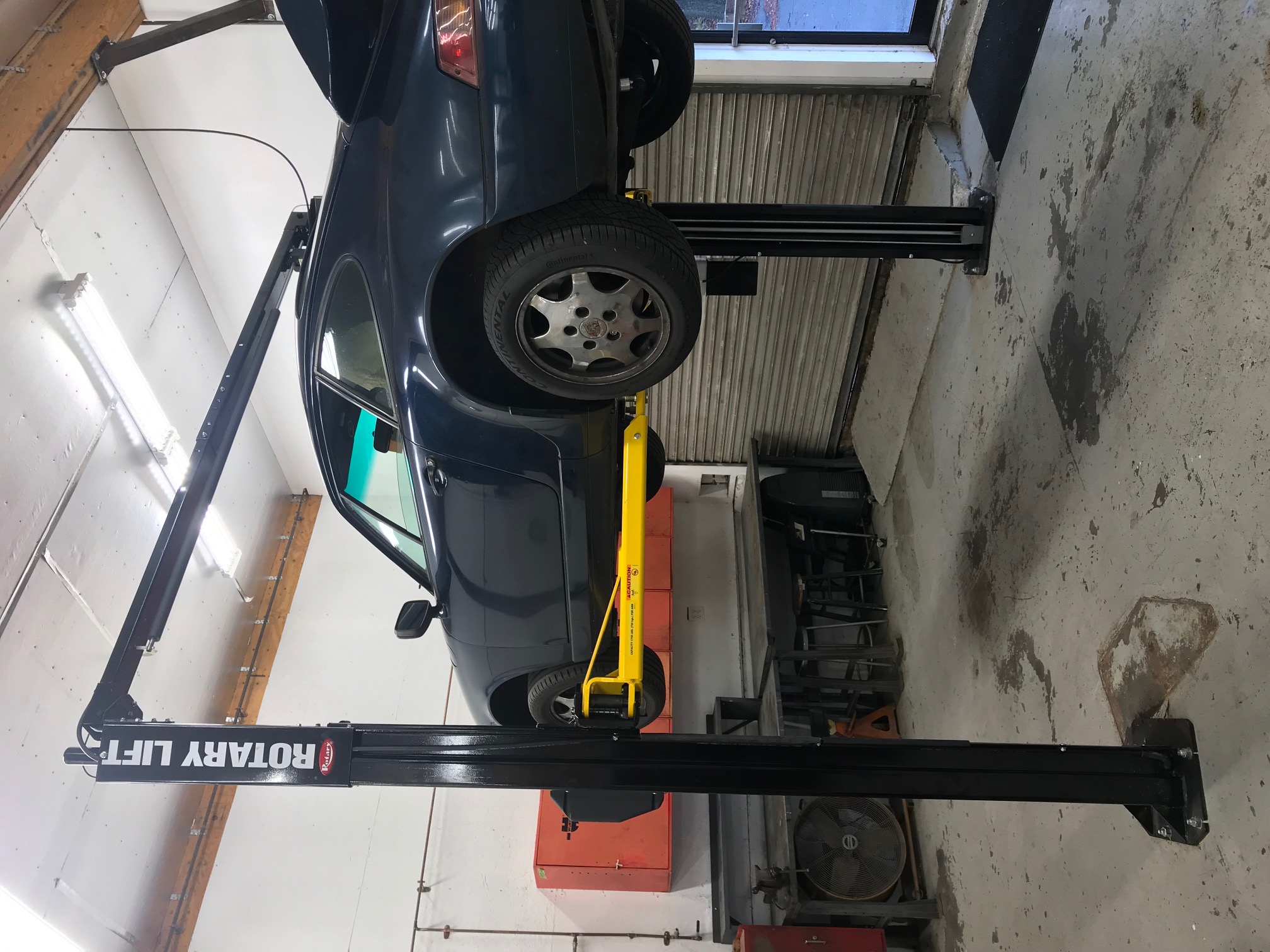

after looking at many many many lifts and lift manufactures, doing as many 914s as we do we chose rotary lifts. They work perfectly with a 914 and other Porsche modelsAttached Image
That's what I use. (IMG:style_emoticons/default/agree.gif)
