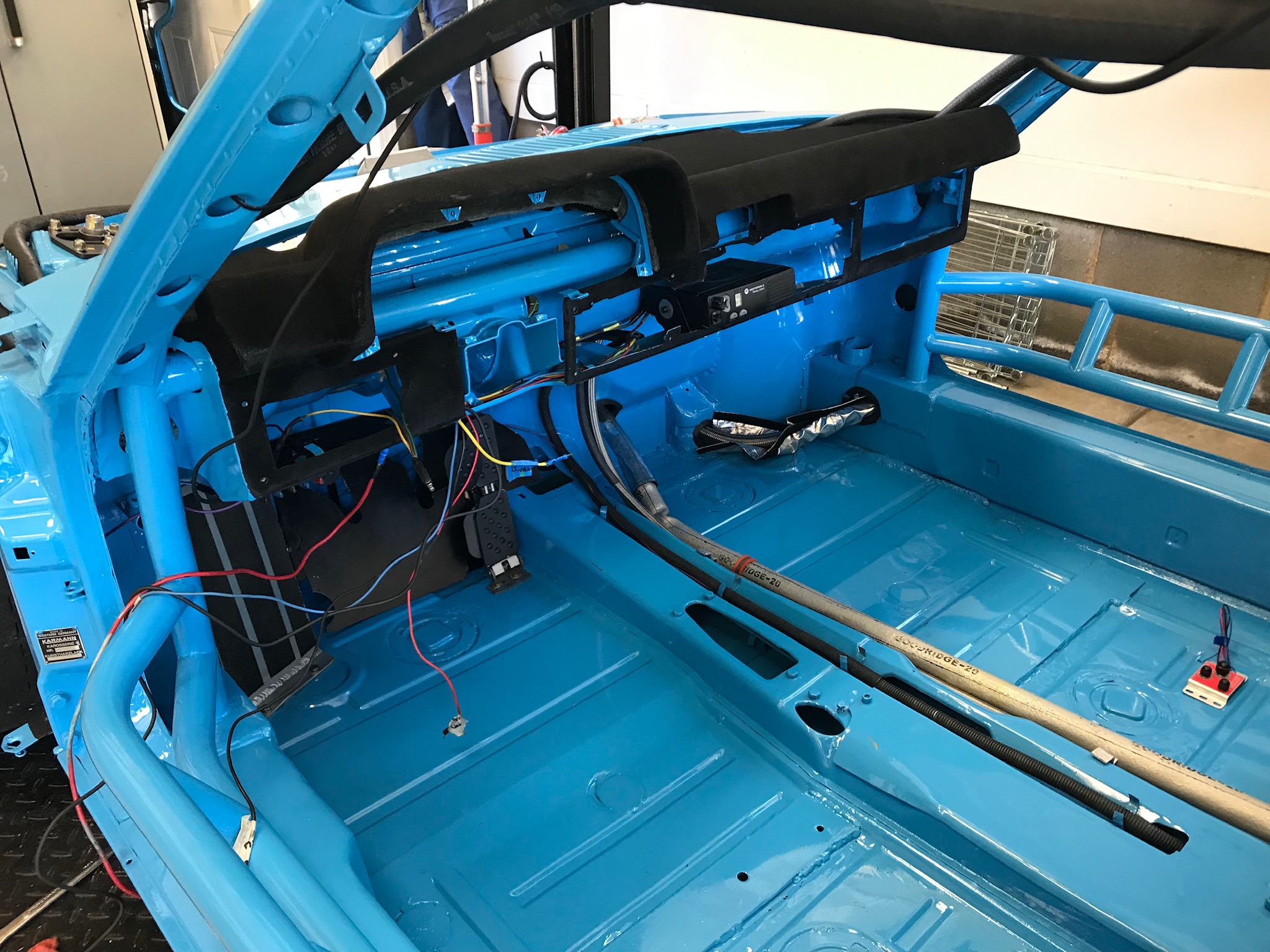

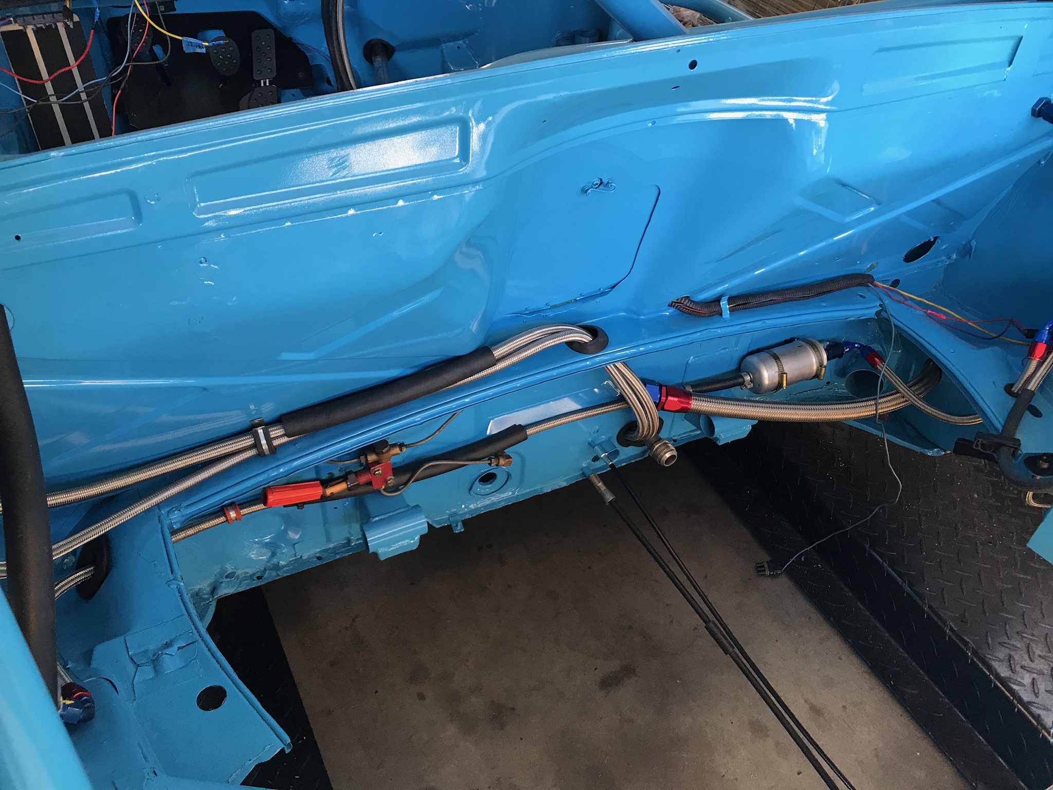

Update from this weekend. Started on the electrical..We have no idea what we’re doing with that but figuring it out as we go!! Biggest change is a new Cartek electrical kill switch vs. the manual one. Very different system and we’re moving the battery (among other things) so everything electrical is different. Plus, going to have a full AiM MXL2 system so sorting that out with what sensors we need and how they run. Nadine made a new dash face out of carbon fiber, but we still need to cut holes for switches and such so its not installed yet. Plumbing is done, brakes are bled with new Carbotech brakes. Lots of little things done...not as much as we’d like but getting there...
