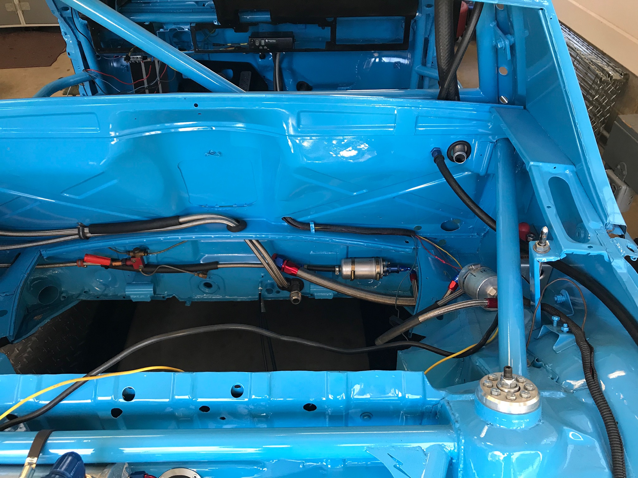

We decided that this winter, our 914 race car "Papa Smurf" needed some love. The engine that Dawe's Motorsport built has been flawless for 2 years now, but it's time for a refresh. The 915 transmission is so poorly geared and with no limited slip that it has been a huge hindrance to race with, so that's getting redone.
So while everything is out, I figured it was a good time to fix all the damaged fiberglass body panels, fix the newly found crack in the chassis, strengthen and reinforce everything, tie suspension points to the cage, re-route hoses and lines to be cleaner, redo some of the wiring, add lightness where I can, fix the roof (came flying off at Road Atlanta and cracked it), etc. etc. etc. Essentially tear it down to bare chassis. Then media blast the whole thing (fix any rust spots we might find), powder coat, paint or wrap what needs what, and reassemble...hopefully before our first track event in March!!
I will post pictures, progress, video, etc here if I can remember to. Honestly...I NEED to take detailed pictures and video so I can remember where everything goes!! Just might be delayed in posting.
So...engine/trans come out Friday and the fun begins...
As he sleeps peacefully today on the top bunk:

naro914   Update from this weekend. Started on the electrica...   Feb 24 2019, 08:28 PM
naro914   ...   Feb 24 2019, 08:29 PM
