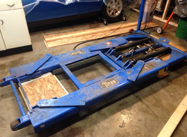

As some of you know, I just bought a mid rise lift used. $900. New 1500. 6000lbs.
Max lift height of around 60in. Depending on adaptors used, can be more, less. Haven’t used it yet. But some have chimed in already. Nobody regrets buying a lift.
