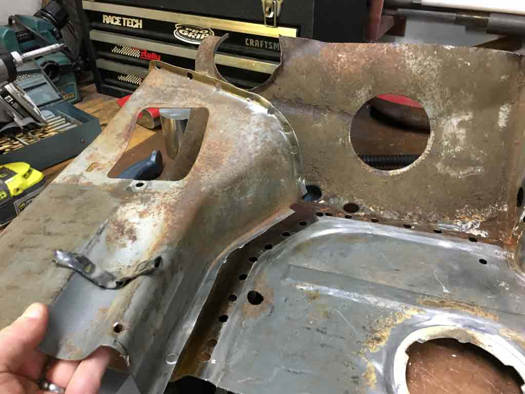

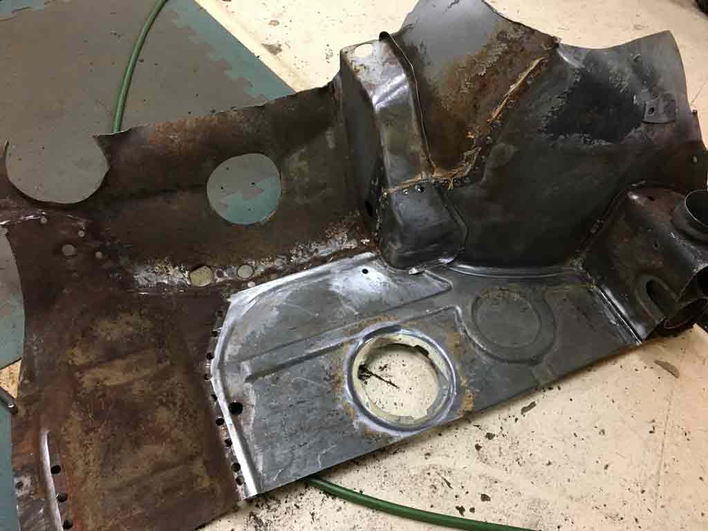

@porscheaddic
Came to my rescue and provided a whole front lower cowl as a donor. I can't say enough good things about Vince!! (IMG:style_emoticons/default/smilie_pokal.gif) His prices are reasonable and he was willing to help ensure I got sound metal and the right cuts to work with my need.
The time it takes to deconstruct stuff is amazing. Lots of drilling spot welds and maybe some profanity is the order of the day.
Piece by piece I finally started getting to the individual panels I'll eventually need to piece this all back together into my vehicle.
