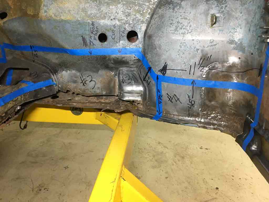

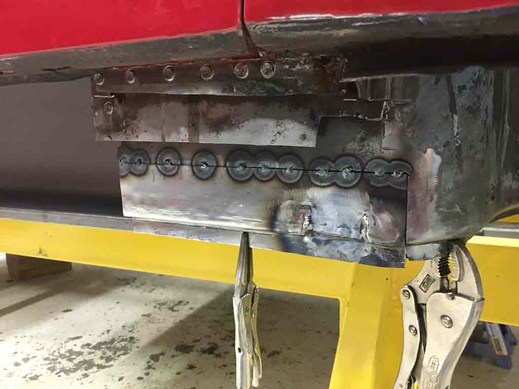

The other thing that has derailed my effort to get the long in place is that the Tin Worms have consumed the lower 1" of just about the entire perimeter.
I suspect that someone repeatedly left the Targa off this vehicle and it got filled with water. (IMG:style_emoticons/default/mad.gif) leading to all the corrosion on the lower 1" of the entire floor pan.
So before I can weld in the longitudinal I need to get some solid metal back in the lower cowl and wheelhouse area.
I started to fabricate the lower couple inches of the longitudinal outer.
But the more I got to thinking about doing a from scratch fabrication I decided to see if I could find some donor sheet metal. The tight radius bends and the compound curvature of the wheelhouse weld flange was just going to be agonizingly slow to do from scratch.

QUOTE(Superhawk996 @ Mar 15 2019, 10:19 PM) *
That area gave me fits for the reason you mentioned. I got plenty of practice making multiple attempts until I got it right. Donor piece is the way to go.
Looking forward to seeing more about how you tackle that rear wheel house and long without cutting the fender. I'm really enjoying watching the quality work. (IMG:style_emoticons/default/beerchug.gif)
