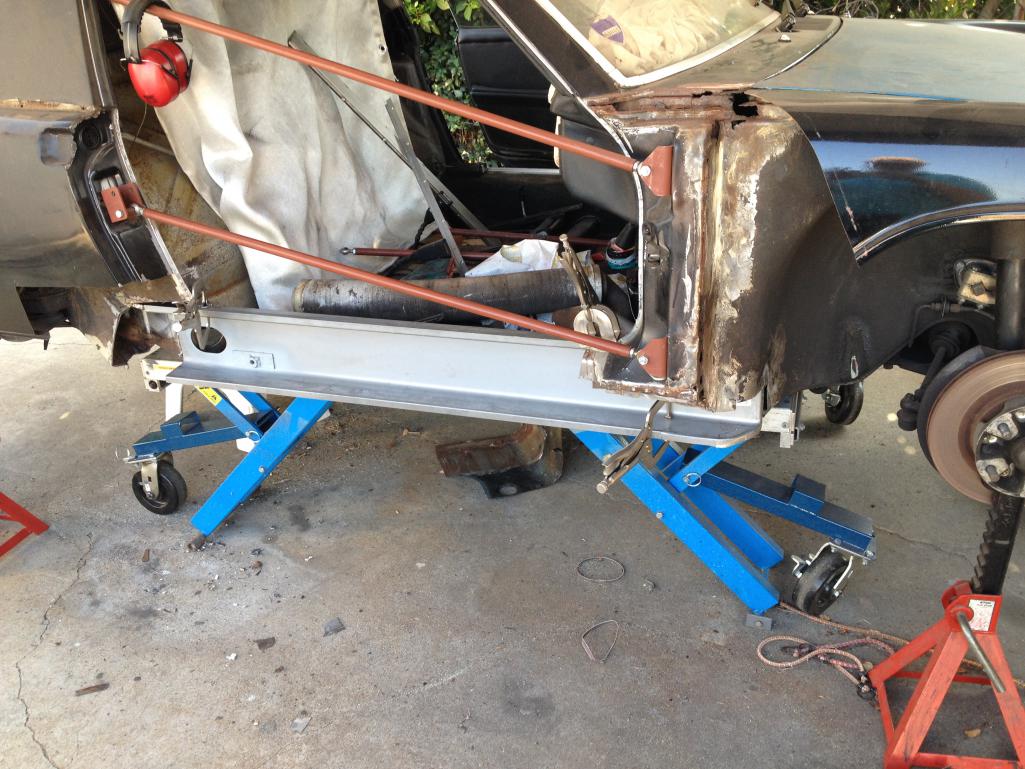

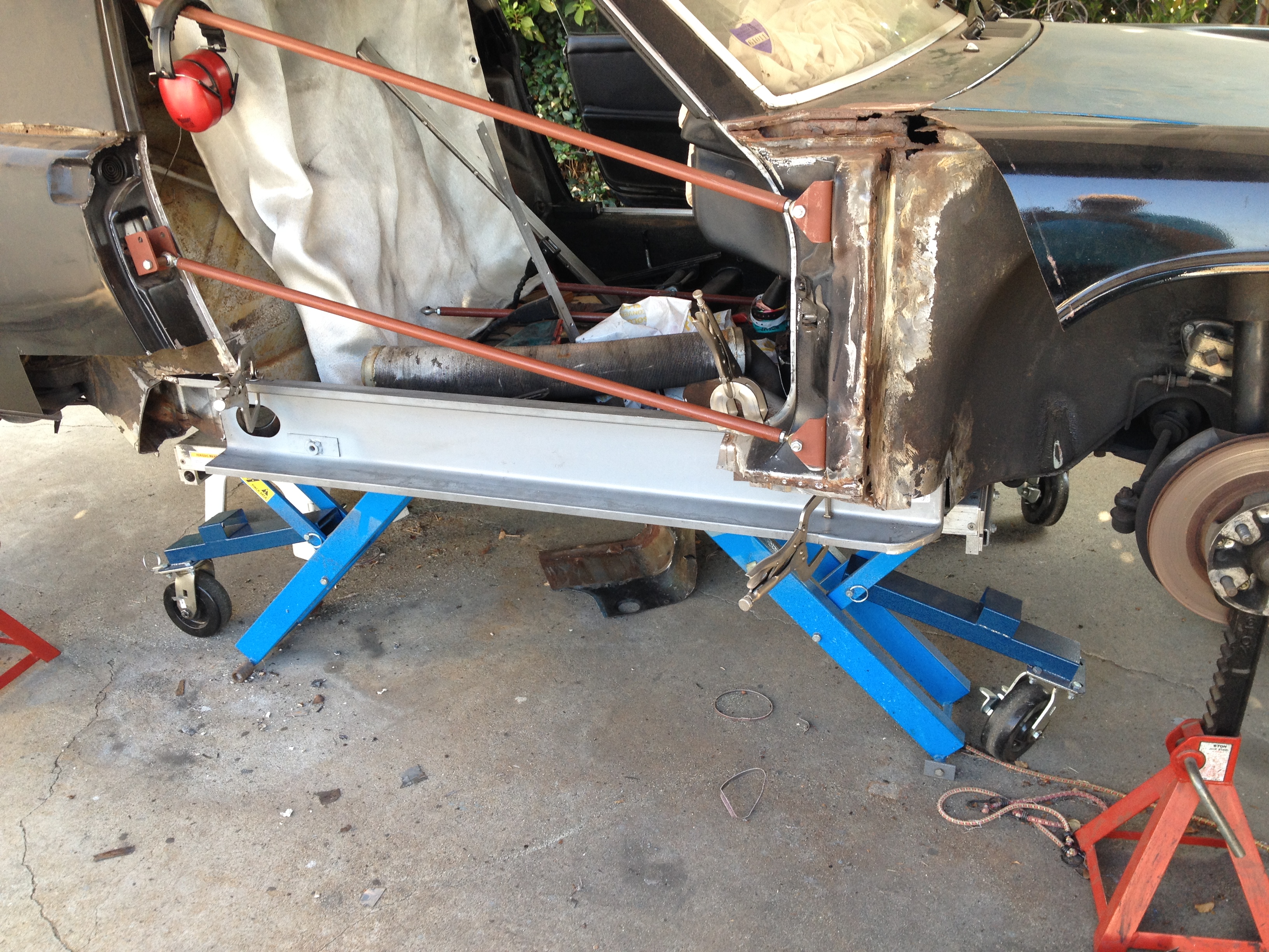

Question: Does anyone know why the AA inner longitudinal has two seat belt bolts? My driver side and the cutout part only had one. I can't see the point in this. I'm likely to cut the 2nd out and fill the hole so that I only have one like the original.
I bought the same part through Sierra Madre collection, it only had the single hole.
I bought it about 3 1/2 years ago. It was a challenge to install, you’re doing great, do you have a picture of the long from outside of the car?
