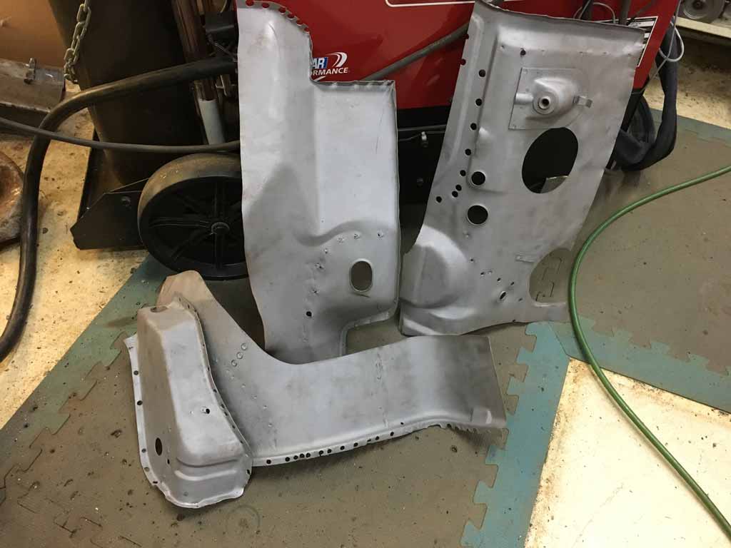

Photo of passenger side donor sheet metal rough trimmed & sandblasted.
Still need to fix a few of the holes from drilling spot welds and then will do a quick dip in metal prep.
