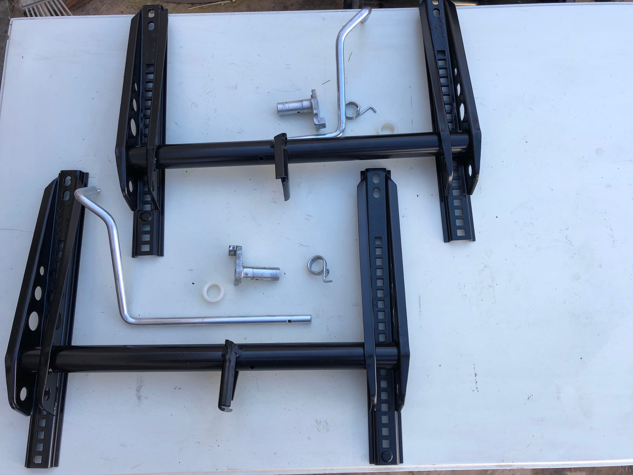

Looking to have my seat frames powder coated and need to remove the non-painted handle assembly as it contains plastic bushings that will melt at high temperature.
Any idea on the correct procedure and tools required for removal?

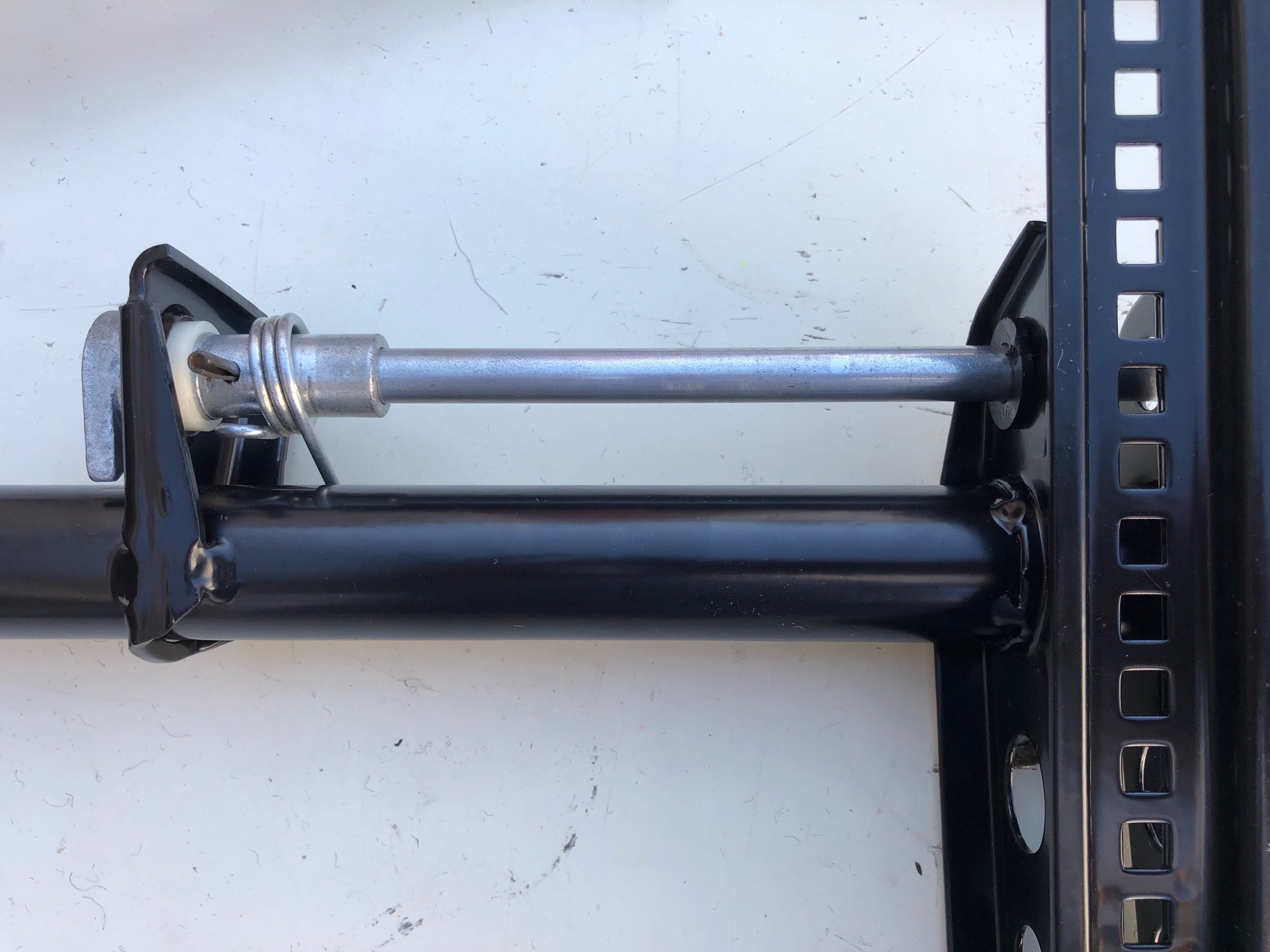

Got the frames back from Powder Coating and cleaned up the hardware. Upon installation, not sure how to get the spring properly seated to the pin and inserted in the frame.
Can anyone chime in on the which side of the spring is installed first or if it is done simultaneously somehow after the pin is inserted?

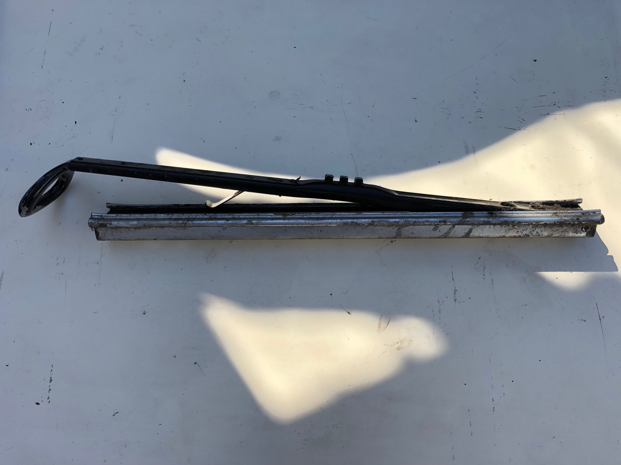

Second challenge is how to remove the seat handle assembly from the rail. There is a single rivet at the back. Is there a simple way to remove and reinstall or would it be better to sand and rattle can the handle and just leave it attached?
