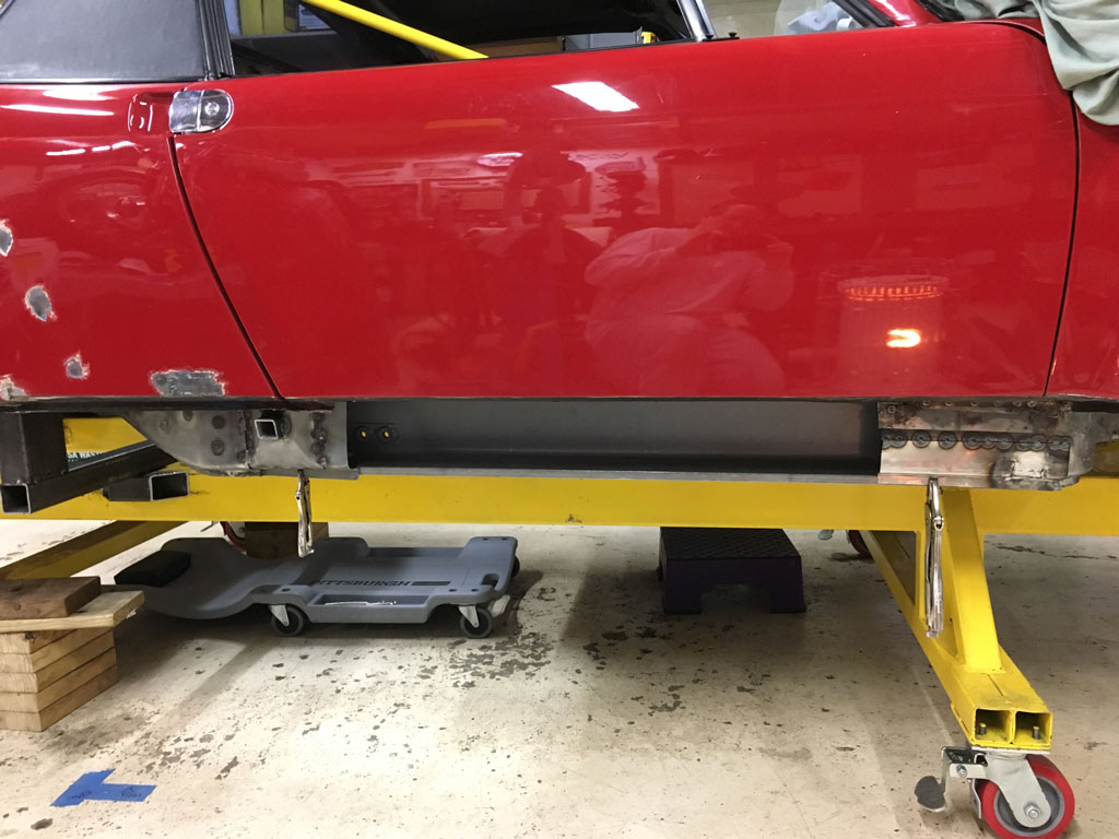

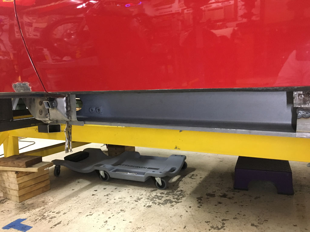

I would like to see a photo of your car sort of the same as mine, I want to see the position of the second hole.
Superhawk996
post Mar 17 2019, 11:42 AM
Posts: 8,135
Joined: 25-August 18
From: Woods of N. Idaho
Member No.: 22,428
QUOTE(mgphoto @ Mar 17 2019, 12:41 PM) *
@mgphoto
Here are two views. I can't get the innerwheel house / jack support out of the photo that is what currently holds it all in the car.
If these photos don't help I can take a picture of just the long with a tape measure.
My thought is the 2nd hole might have something to do with the early longitudinal on passenger side that had a fixed passenger seat and may have had the belt in slightly different spot.
The other more cynical view is that in the 1970's we were all much thinner and maybe now we are all running out "Belts" out a few more notches than we used to? (IMG:style_emoticons/default/confused24.gif)
mgphoto
post Mar 20 2019, 11:54 AM
"If there is a mistake it will find me"
Posts: 1,501
Joined: 1-April 09
From: Los Angeles, CA
Member No.: 10,225
QUOTE(Superhawk996 @ Mar 17 2019, 10:42 AM) *
@mgphoto
I don’t think so, I think the original mount was welded in the wrong place. It looks like the seatbelt mount might be to close to the bulkhead for it to swivel cleanly.
Take your original carpet and see where the holes line up.
Although I might not weld it up, it does leave an access hole. When I started, I got advice from a number of people on this board, one was Brad 914ltd, he said “belt and braces” paint the inside of the long and use cavity wax after assembly.
The original longs have a rubber patch which covers the holes. The extra hole might be useful.
