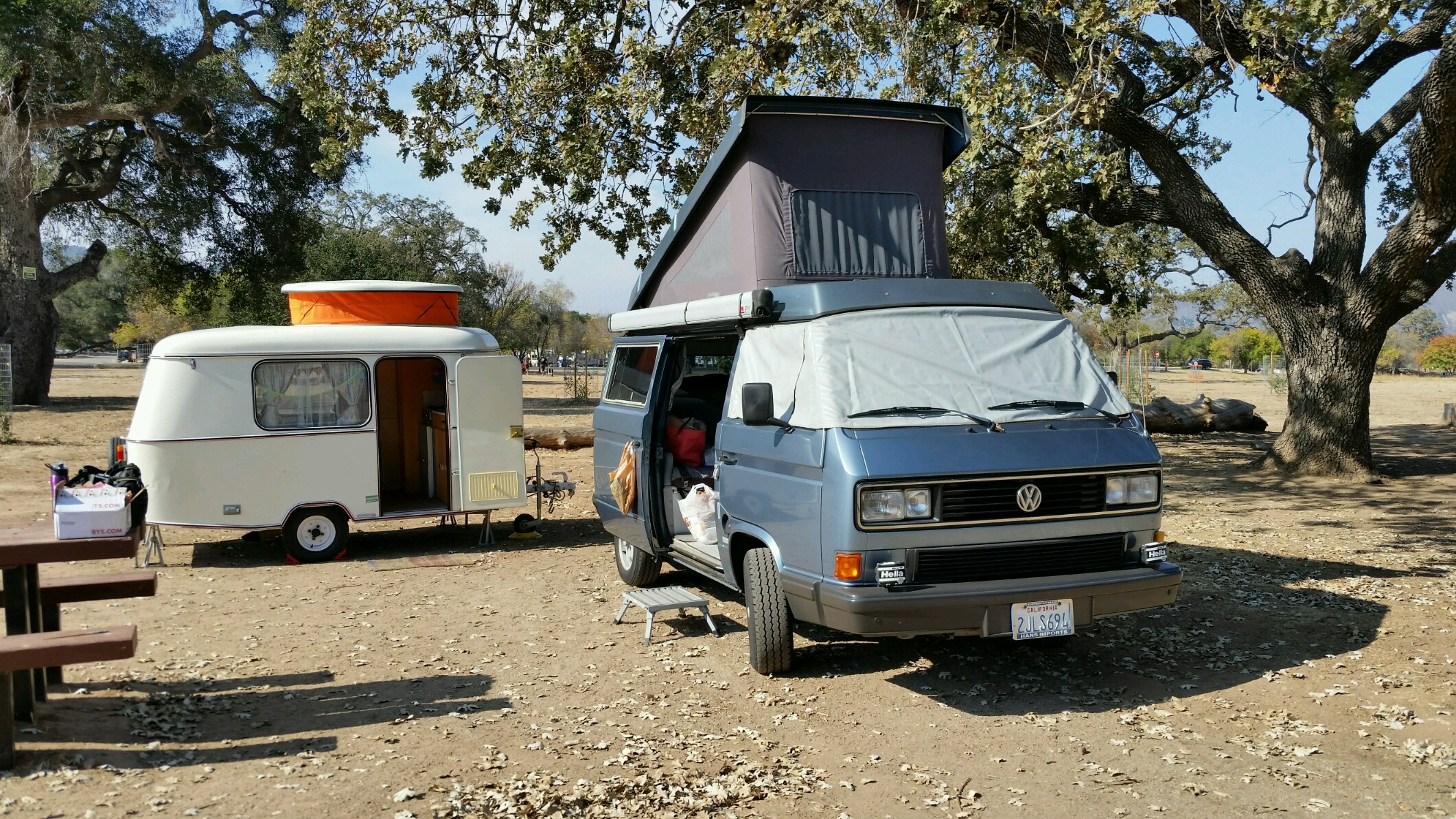

Lastly - anything with a pop-top is the highest value Vanagons, & a well restored full camper Westy would easily be worth $50-$70K+ when you're done - even with a Subie swap, or with a GoWesty or other rebuild/upbuild WBX that's not original. & As with our 914s, the Westy values have continued to go up, & even held flat during the 2008-10 "Great Recession". So IMHO, the Westies are a better economic choice for restoration, than are most 914/4s - which was partly why our OO `88 Westy moved up in front of my 73 914-2.0 when it got clipped in a minor accident in 2013.

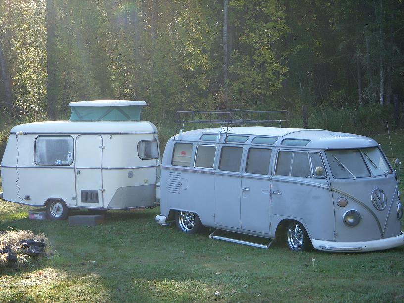

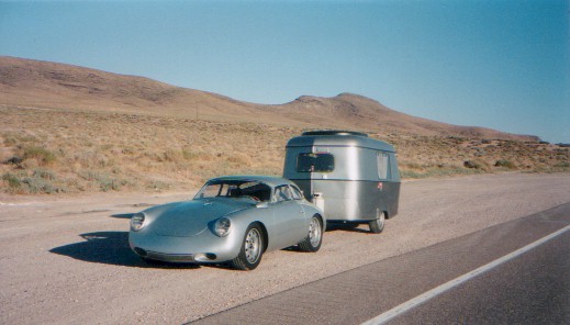

Next thing will be that your wife will want you to find a vintage Eriba Puck to take her to vintage trailer rallies with the Westy towing, as mine did! (IMG:style_emoticons/default/biggrin.gif)
But don't despair - if 1950's VWs with 25 HP & this 356 can tow them, you can also put a hitch on your 914 & tow it too! (IMG:style_emoticons/default/driving.gif)
