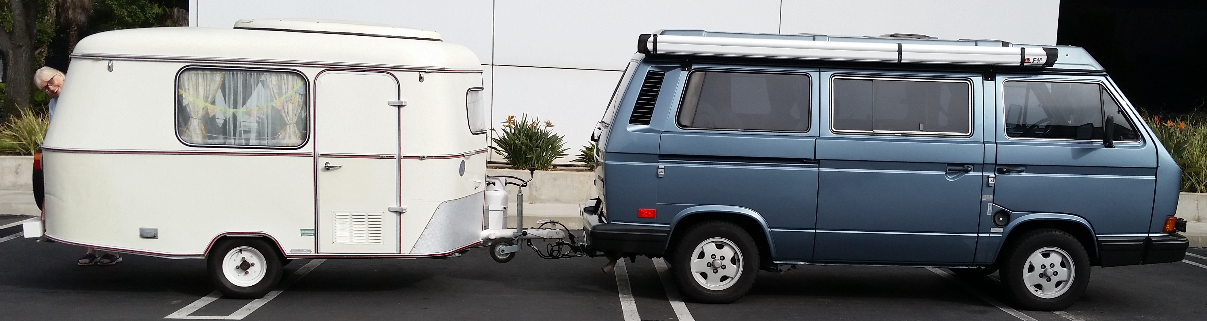

Dan,
Maxxis makes an LT C rated tire better than the original Michelins in both the 14" & 15" sizes which have the stiffer sidewalls that the Westy & Tin-top Vanagons need, but the Michi's are long NLA. That has been the main problem, when tire shops put passenger tires on them with too soft sidewalls & non-LT load rated.
https://www.maxxis.com/catalog/tire-227-104...o-series-ue-168
Give them a try for your next set on your dials, or stock wheels. The driver door sticker lists the Factory specs the sizes & ratings for both steel & allow factory wheels, which they kept small to fit the spare in the front pan - among other things.
I've been running ours on the stock 14" alloys plus 205/14's, & even when towing & in the 30-60 mph big winds this past weekend they were solid, & they're very stable - even with the double sail of the Westy + Puck in the pic below.
