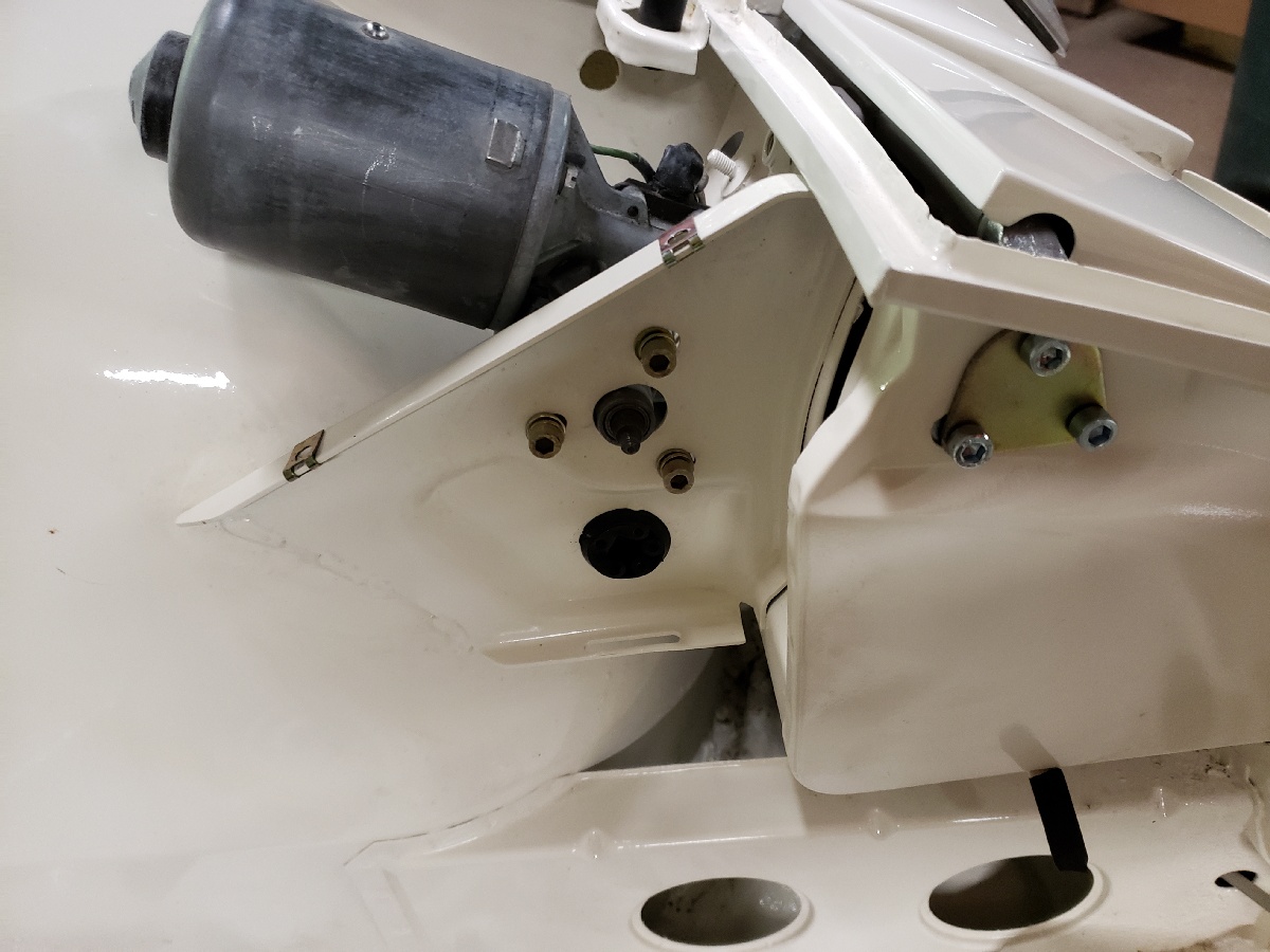

gms   @Targa70 dropped off some parts and visited his c...   Mar 27 2019, 03:01 PM
gms   headlight motor   Mar 27 2019, 08:40 PM
