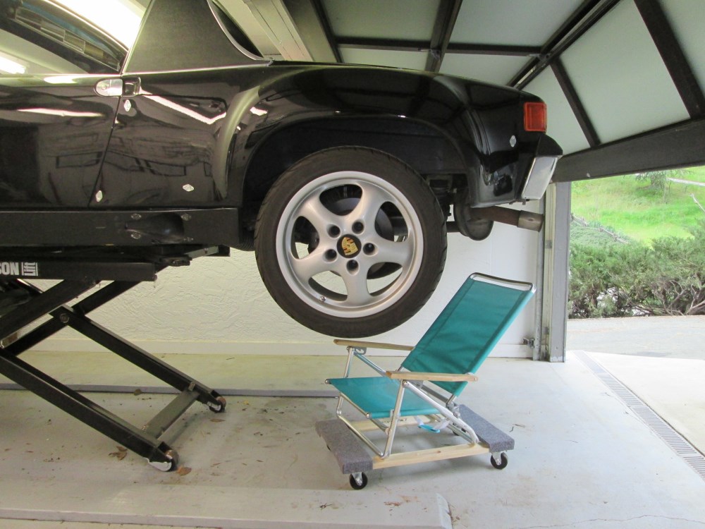

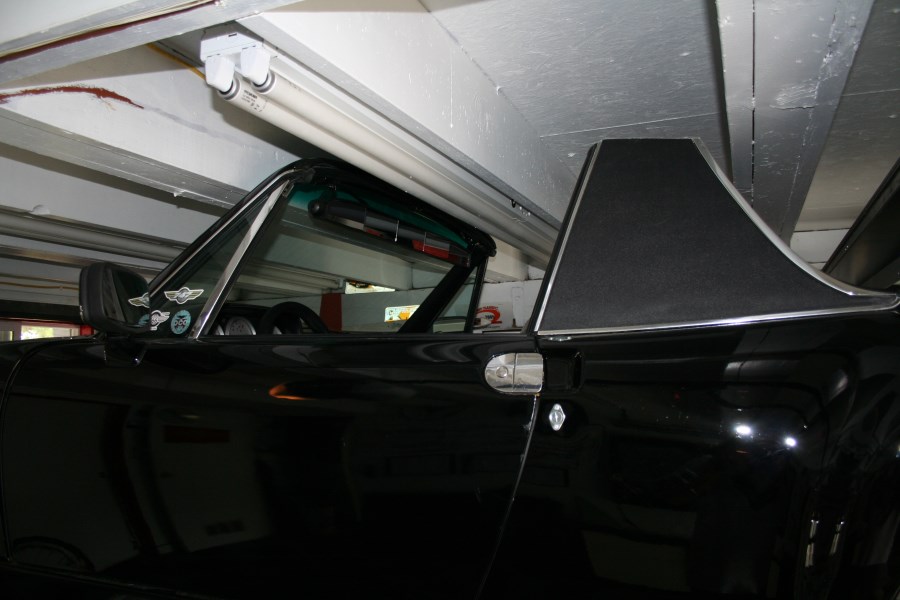

Mid size lifts are great. This garage has a 7 foot ceiling. The lift will go up almost the full 4 feet if the targa bar and the windshield rise up between the ceiling joists. A cheap furniture dolly (shanghai tool supply) and beech chair are great for working under the car. This lift also came with rubber pads that slide on the lift arms allowing for more stability.
