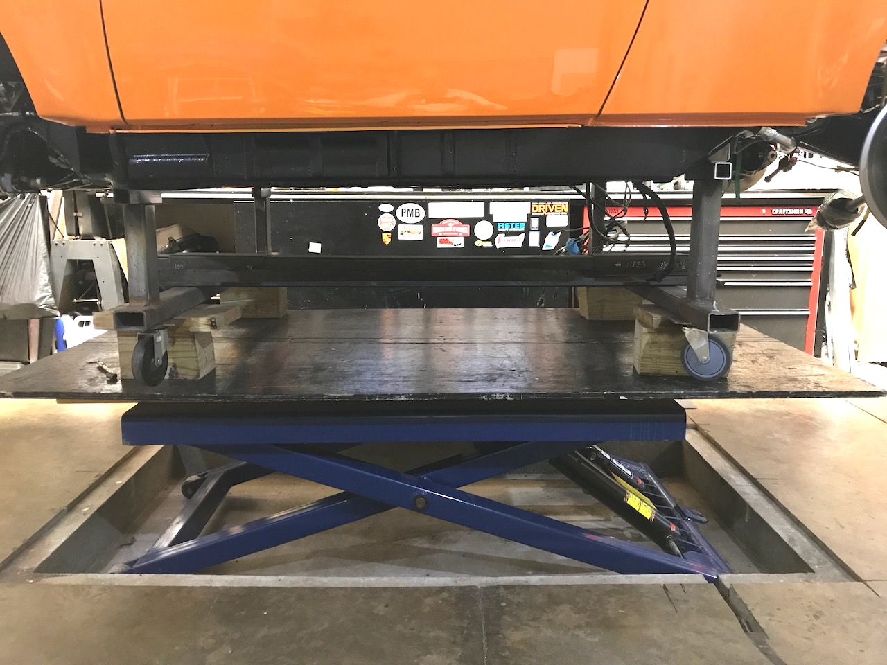

Ben, just get a cement blade for your circular saw. Saw two groves 3/4 inch apart and 3/4 inch deep, hit with hammer/chisel. I ran mine then filled channel with flexible cement caulk. See bottom right corner gives you a little peak of the flat floor. Best, MarkAttached Image
