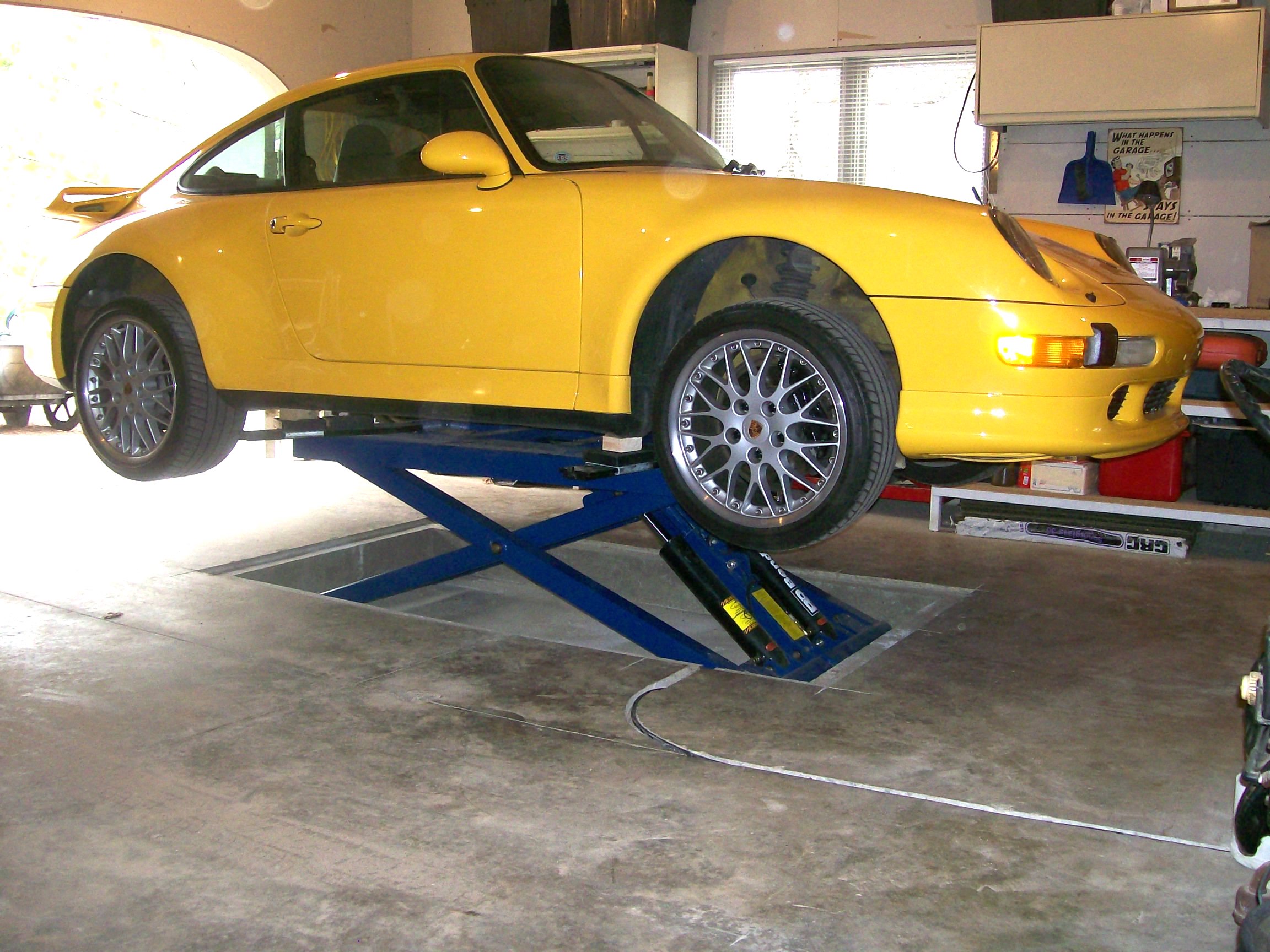

Ben, found a better shot before I filled the grove. Again, lower right corner.Attached Image

mlindner   Ben, found a better shot before I filled the grove...   Apr 4 2019, 12:26 PM

mlindner   914 teener, good question and I do have a Cayman.....   Apr 5 2019, 05:12 AM
