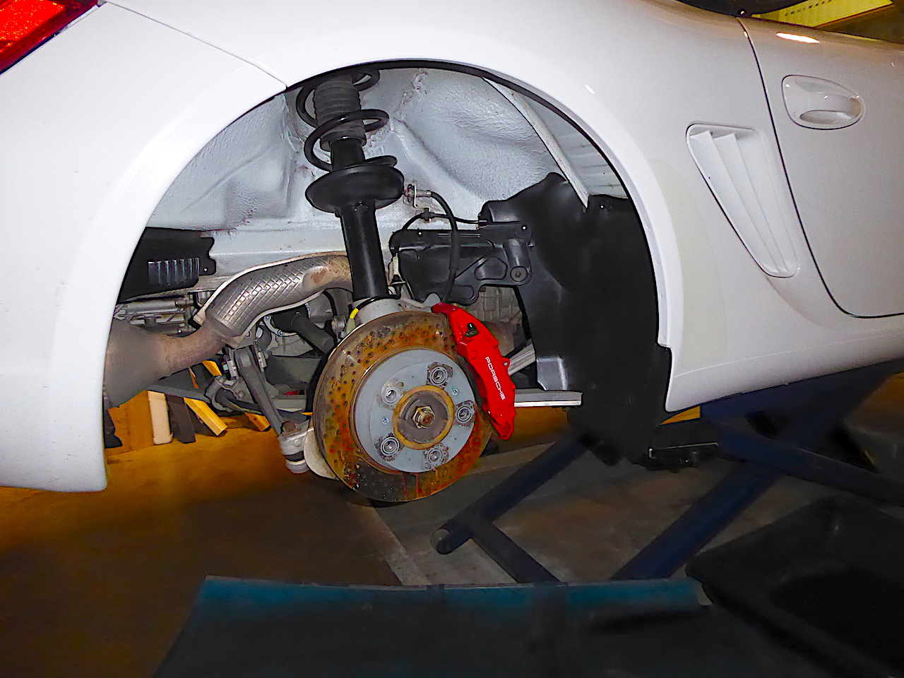

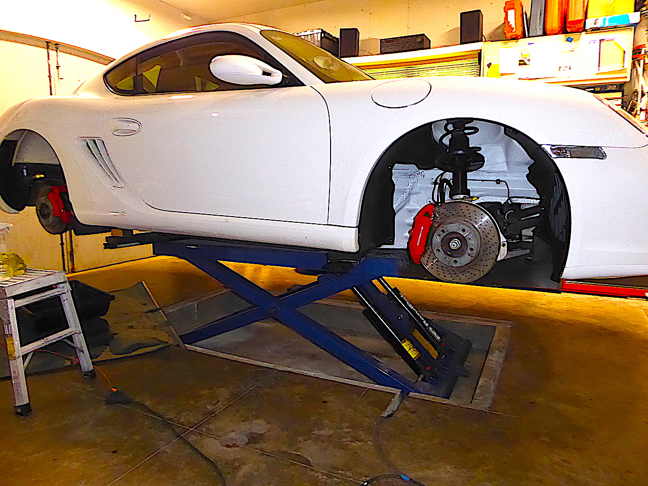

914 teener, good question and I do have a Cayman.....I have not done the water pump or belts yet. I believe with the extra work of putting the extension on and getting the car another 8 inch above the lift it would work. The few pictures I have of the Cayman were just to clean last year before the parade. Best, MarkAttached Image Attached Image
