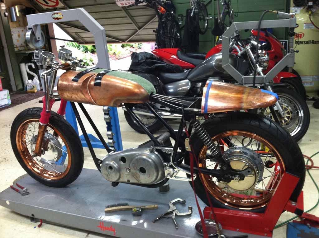

I was saving my effort doing complex metal forming for motorcycle projects that are currently on hold while I do the 914.
Wife no longer willing to ride on the back of motorcycles. (IMG:style_emoticons/default/WTF.gif)
Started this Norton Commando cafe in 2012. Metal fab still stuck at this state although I did get the engine and trans rebuilt and added into the mock up.

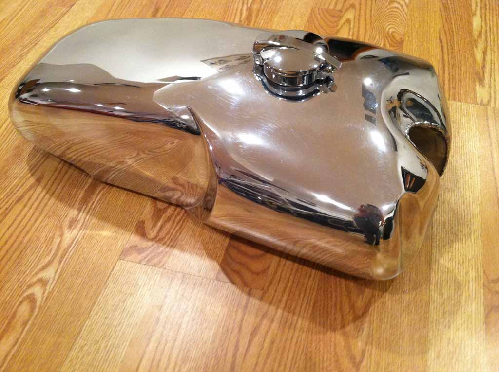

Previous aluminum tank of similar design.
