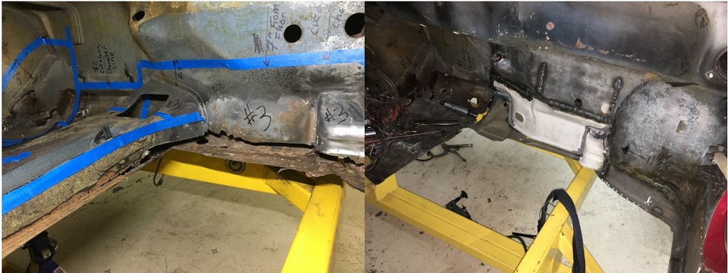

Been a little bit slow posting lately. Spring and yard work and honeydew list is competing for time.
Today I'm at the butcher having bits of of my face carved up to remove some minor skin cancer. The good news is I can catch up on my posts between butchering sessions.
I am still working on the passenger side cowl to get that fixed up.
Here is a before & after view.
