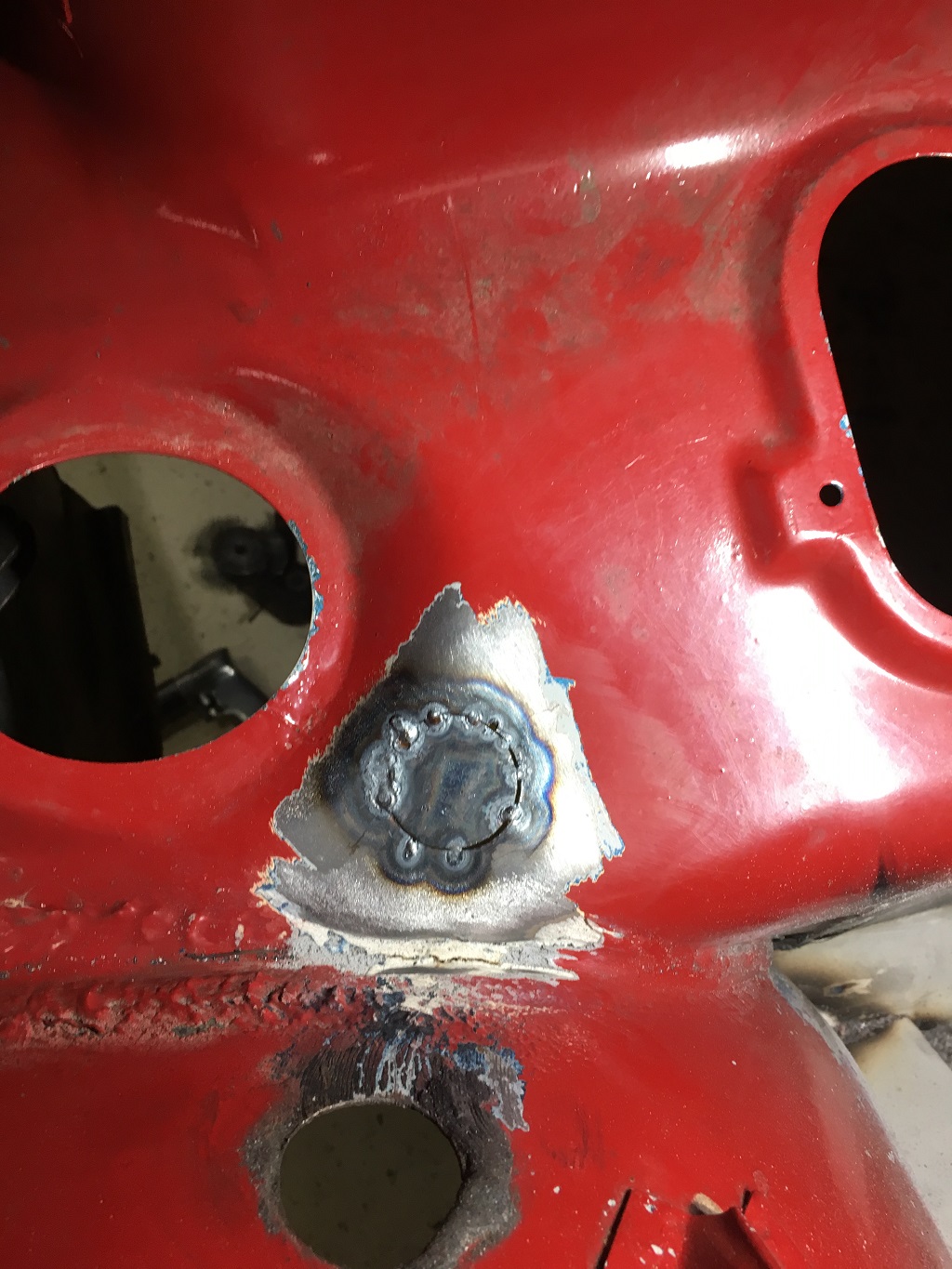

The other thing that led to rushing the job was all of this welding is out of position welding and needed to be done with me sitting or kneeling in uncomfortable positions on the floor while working in this area.
Nothing leads to rushing more than being uncomfortable.
The other key thing is that is worth repeating is you can't weld what you can't see. some positions that I was forced into obscured my visibility to to the weld puddle. Not being able to see the puddle is a great way to let it get too hot and to burn through.
To top all this off, my cowl area has an abundance of holes (other than rust) that needed to be fixed.
1) A/C holes were cut for lines to pass through.
2) Sheet metal screws were randomly punched though the cowl area to support the A/C unit itself under the dash.
3) whenever a previous owner wanted a ground connection, they just shot another screw though the cowl.
I've started to address the large A/C line holes. The only problem here is this is overhead welding. Even more fun!
These holes are tucked right into the corner of the cowl & fender area.
I tried to weld this in from above but my welding helmet prevents me from getting my face in a good position to see the weld puddle. You can see this by the tack weld at about the 7:00 position of the hole -- completely missed the weld gap! Cannot weld what you cannot see! . I resorted to doing the other tack welds from inside the passenger compartment and from below.
I don't like this solution. I think my next try will be to use a gas lens and hang my Tungsten as far out as I can hoping to get better visibility to the weld. Trying to be slow and patient and find the best welding position to do this. If I start blowing holes in this area I'm screwed.

Superhawk996   @Tenner [b]Looks like nice work. You most defin...   Apr 29 2019, 04:44 AM
bbrock   @[url=http://www.914world.com/bbs2/index.php?show...   Apr 29 2019, 08:11 AM
injunmort   brake piston   Apr 29 2019, 10:18 AM
Superhawk996   brake piston Good guess . . . but it would ha...   Apr 29 2019, 11:40 AM
