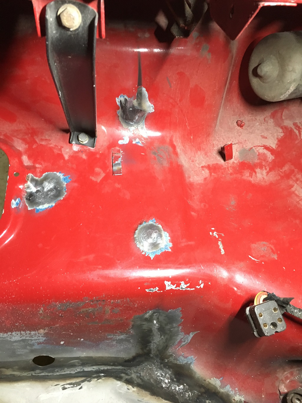

These are the easy ones. Just a quick dab or two of filler to weld up the sheet metal screw holes.
In just this photo, there are 3 holes! There are more on the driver side and one of them is about 0.5" diameter. I'm not sure what was run though that hole but is just the right size to be a a PITA.
1) it's behind / above the fuse block which will necessitate removal of the fuse block and wiring to access it.
2) 0.5" is just big enough that you can't easily trim a metal blank to fill the hole and therefore you just have to fill it by gradually adding filler around the perimeter of the hole until it can be closed up.
Can't wait to get to that one. I'll defer until I start working on the driver side of the car.
One point that I wanted to make as an engineer to those that might be thinking why worry about a few little holes. Don't forget that just in front of you is the gas tank. In a worst case crash / fire type accident, you don't want holes in the front cowl that could easily allow fuel and fire to enter the passenger compartment.
I know that the plastic vents and paper heater tubes won't last long in a fire but they do buy you seconds to minutes of time. a big 1" hole like one of these A/C hose pass through holes would allow fuel and/or fire access to the passenger compartment completely unimpeded.
Better safe than sorry!
