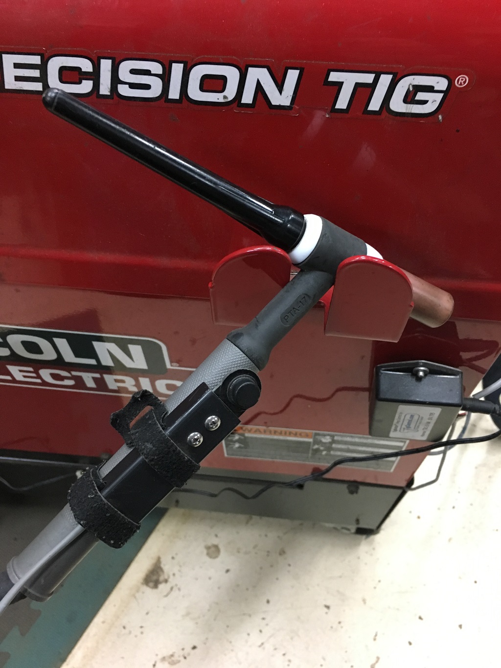

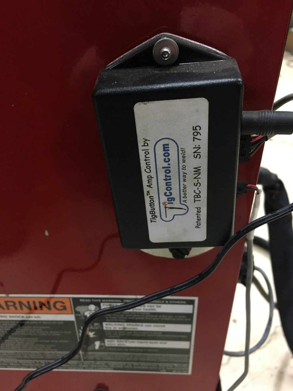

@Tygaboy
I'm a TIG lover due to the flexibility to weld so many types of metal and for the control it offers. If I burn holes I can't blame the equipment - It's my fault.
But boy is it slow for this type of work! Every week I contemplate buying a MIG but I haven't rationalized it yet. I do think that if I do I would sell it once this is done and try to recoup some of the cost.
For you other TiG lovers, I have to plug this product. It is a pressure sensitive Amptrol. No need to move finger to control amperage - just press harder or lighter.
I really haven't done much out of position TIG welding in the past. Most of it has been on a nice comfortable bench. I couldn't live without this.
When I first started to weld up my build cart, I was using my standard footpedal and doing all sorts of Yoga to try to weld and control the pedal with my knee, leg, elbow or whatever. I was pretty much impossible and led to the purchase of the TIG button.
http://www.6061.com/tigbutton.htm
