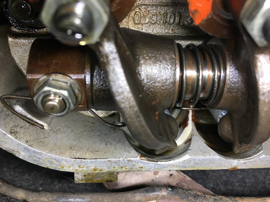

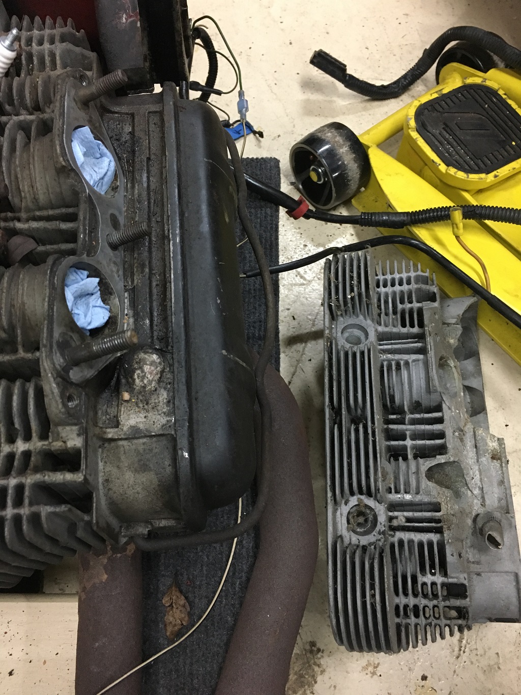

The other work that has started in April is beginning to think about what to do with my engine.
As purchased it was setup with carbs. I've been thinking about returning to fuel injection.
As part of that I pulled the tin to see if the cylinder head temperature (CHT) sensor was still there.
As the subject of another thread, I found that the CHT is missing and even worse, the head isn't drilled and tapped for the CHT. It isn't on the cyl 1/2 side either. Apparently at some point the heads were swapped.
Turns out that they are at least the proper 2.0L cylinder head as verified by part number. In the photo you can see the start of the proper 2.0L P/N 039 101 371A
I pulled out my old broken 1.7L head from my original car just compare when I was in a panic thinking that they might not actually be a 2.0L head.
Also notice that some goober welded up the breather hole.
I guess I'll be doing some machine work!
That 1.7L head was broken when my original 914 was rear ended. It has served as a learning bed for how to remove valves, valve guides, and how to weld cylinder heads! Still got some use again as a comparison to remind myself of what the difference looks like between 1.7L and 2.0L heads. My wife calls me a pack rat and can't understand why I would still have a cylinder head around from a car that was wrecked before the turn or the century. (IMG:style_emoticons/default/poke.gif) Women! (IMG:style_emoticons/default/screwy.gif)
I still haven't dug into the engine but fully expect that the cam has been swapped given that the heads aren't original.
