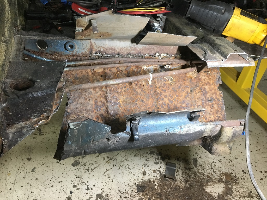

Here is what is lurking underneath once the rockers came off.
and when I started cutting back the rust. Oh my . . . .

Here is a bit of previous work. I removed the tunnel to better access the cowl for repair and because it was completely shot.
I figured it would be easier and a better repair to replace it completely rather than patch up what I had.
Here is the dissection to show it's internal condition.

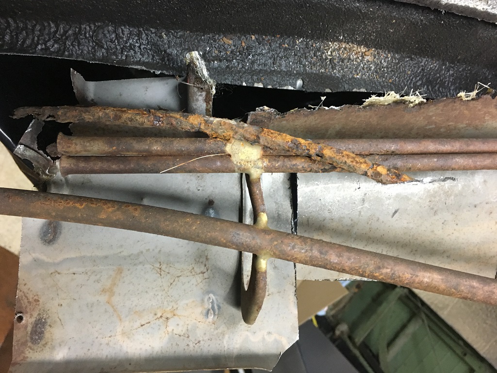

For any of you having problems removing and/or installing new throttle and/or clutch cables, don't rule out this possibility.
When I 1st was getting this car running, the throttle cable was stuck. When I pulled out the old cable, it hung up about half way out. I had to break it to get it out!
In order to get the car running, I cut a hole in the tunnel, and cut out a section of the tube and just fished the cable up to the pedal sled. It was a quick fix but wouldn't have been a good long term solution. The photo above shows why!
