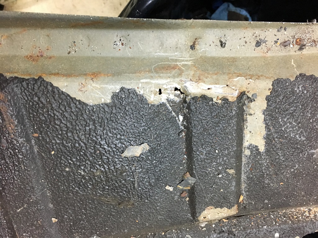

For all you guys that think just a little rust in the floor pan isn't a big deal, here is what the bottom of the tunnel looked like from the outside. There is always way more rust than what you can easily see.
Random pin holes were hidden underneath the undercoating.
Not much of the previously shown damage was visible when I purchased the car but it was there none the less. Keep in mind how pretty this car looked top side. Really nice looking cars can have extensive rust hidden within and/or not easily visible without detrimming the carpets, rocker panels, etc.
Here is a reminder of how the car looked as purchased. Rust is Deceiving. (IMG:style_emoticons/default/happy11.gif)

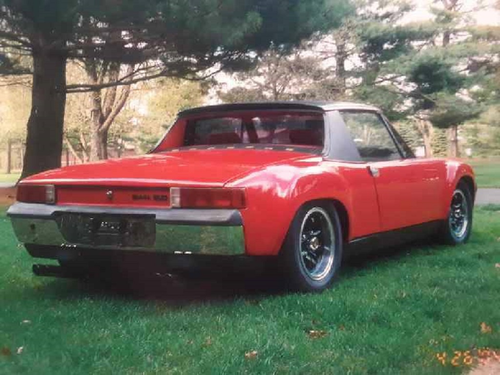

Superhawk996   So here is a fun picture of my original 914 back i...   Dec 23 2018, 11:53 PM

Superhawk996   Here is the Miata in it's prime as a MUV. Mia...   Apr 28 2019, 05:27 PM
bbrock   Here is the Miata in it's prime as a MUV. Mi...   Apr 28 2019, 05:57 PM
