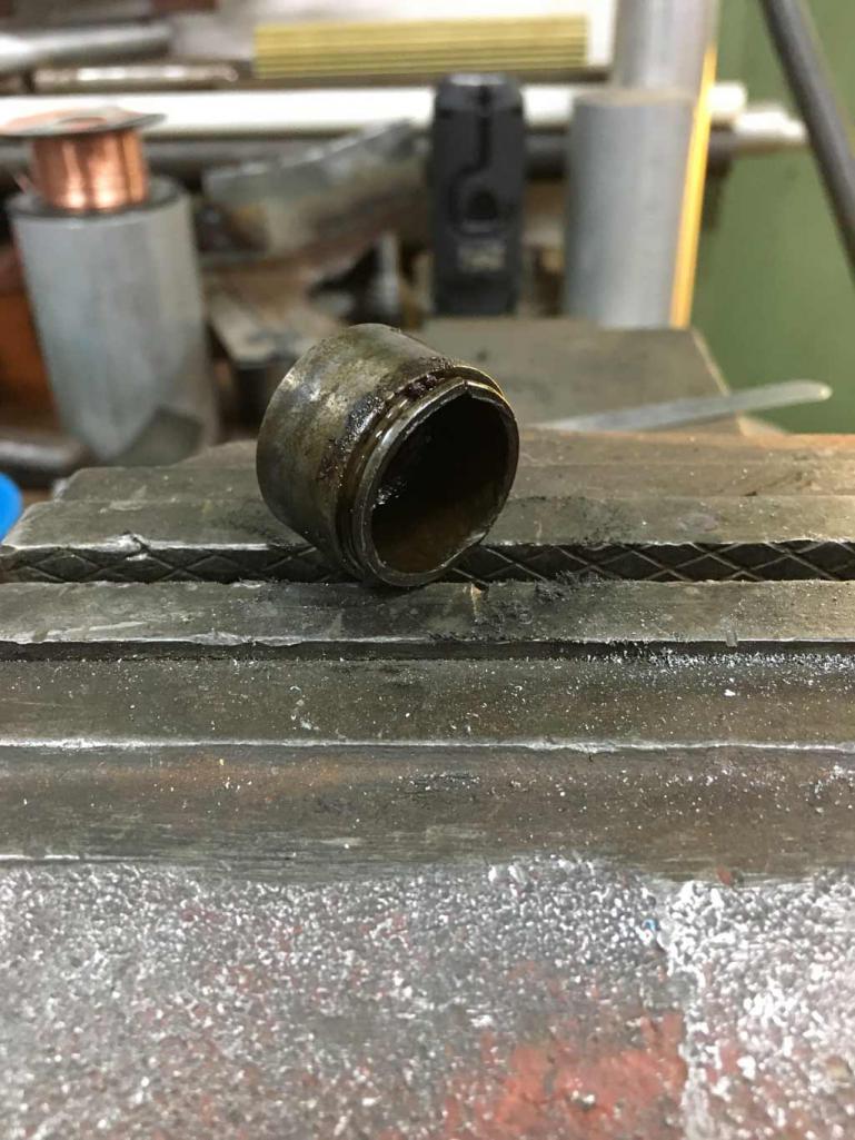

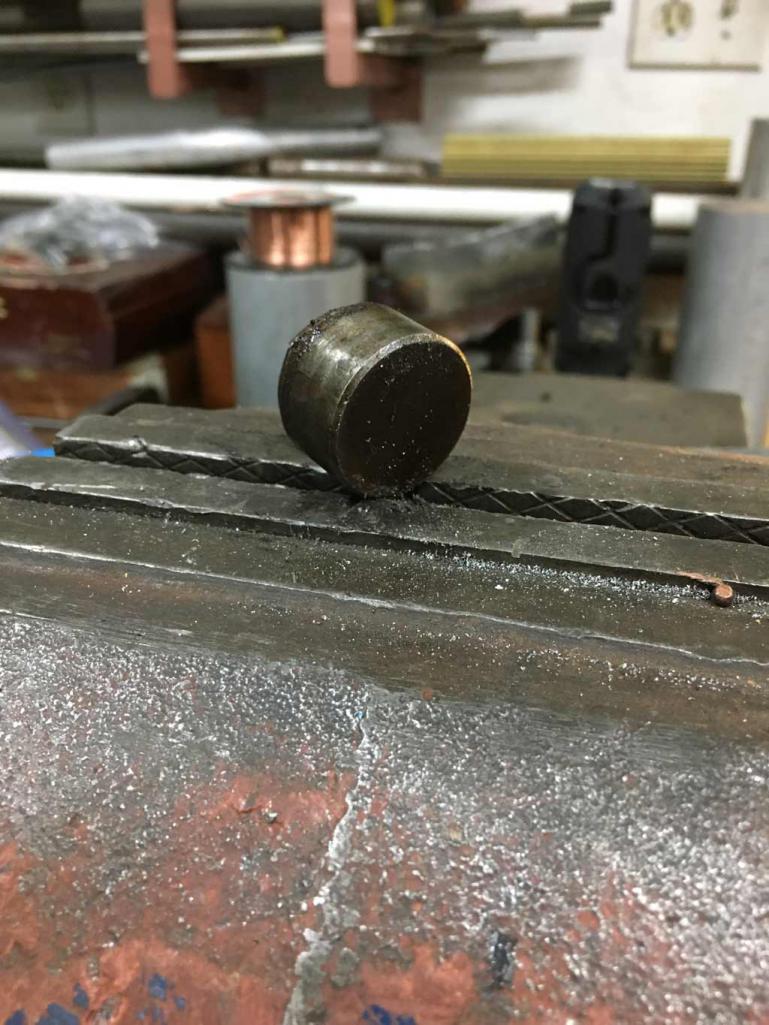

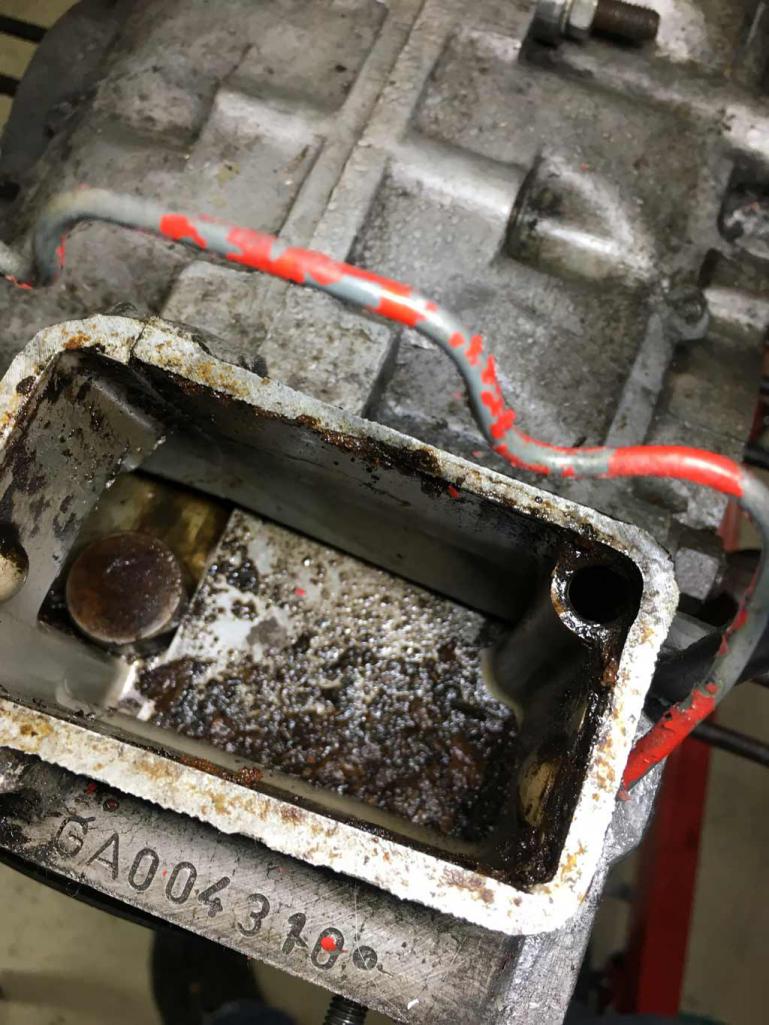

When I pulled the oil breather off the top of the case I was horrified. Here's what I saw.
Worse than the rust debris / garbage there is some sort of round metal object in here. Luckily it was too big to ever fall into the case.
I have no idea what this is or where it came from. Any ideas? Here are two views of it

Dave_Darling   Worse than the rust debris / garbage there is som...   Apr 28 2019, 07:02 PM
bbrock   Worse than the rust debris / garbage there is so...   Apr 28 2019, 07:31 PM
restore2seater   I have no idea what this is or where it came from....   Apr 29 2019, 08:04 AM

Tenner   A few posts earlier, you've been talked about ...   Apr 29 2019, 02:55 AM
injunmort   to fill pits in rocker covers, try boiler cement. ...   Apr 29 2019, 04:33 AM
Superhawk996   @Tenner [b]Looks like nice work. You most defin...   Apr 29 2019, 04:44 AM
bbrock   @[url=http://www.914world.com/bbs2/index.php?show...   Apr 29 2019, 08:11 AM
injunmort   brake piston   Apr 29 2019, 10:18 AM
Superhawk996   brake piston Good guess . . . but it would ha...   Apr 29 2019, 11:40 AM
