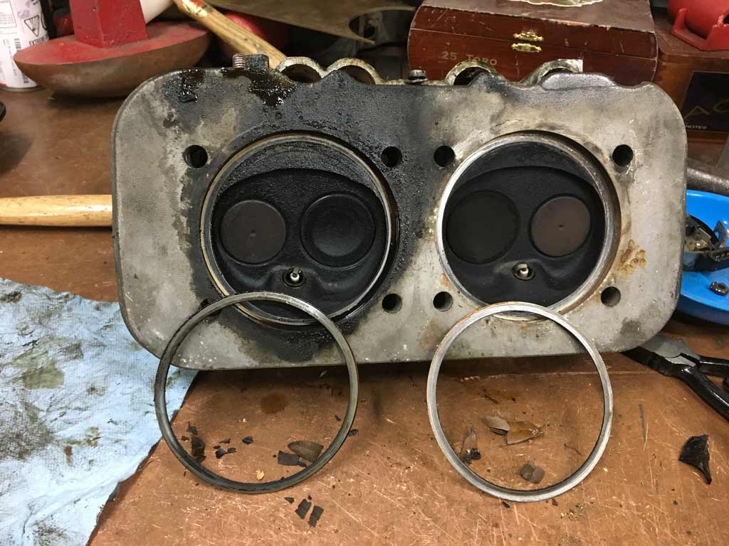

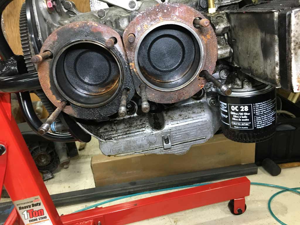

On a more positive note. Most of the other engine components are in pretty good shape upon 1st look.
Lots of oil leaking on the case from push rod tubes, some weepage at the base of the cylinders.
Crank seals are hard as rocks and leaking profusely from getting it running and the brief neighborhood drive. Oil cooler seals were hard too and leaking.
Oil pressure sensor hole is indeed stripped and leaking and will need to be re-tapped.

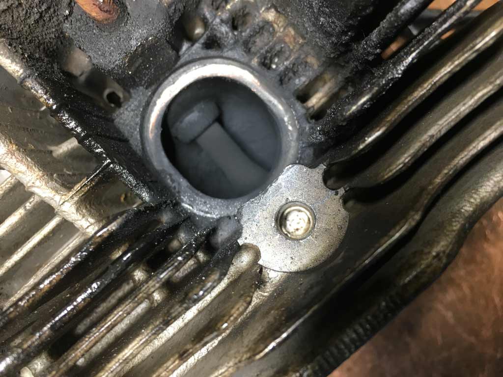

Overall I'm relieved to find the cylinder heads are 2.0L parts and I think the valves may be original. IIRC the exhaust valves with the little dimple in the center are the original 2.0L sodium filled valves. I'm not sure - have to do so research on that. Regardless, all valves will get replaced at rebuild.
I also was happy to find the exhaust stud that I knew was missing appears to actually be a pulled timesert. The hole appears to have been drilled properly by a machine shop since it's located properly and not offset to the original stud bore.
A couple of the cylinders are scored and one appear to be pretty corroded on the bottom of the bore. Probably from the long period of storage and condensation inside the cylinder forming. New pistons and cylinders planned so not a big deal. Was also happy to find the cylinders are 94mm and not some big bore conversion that machined the case or the heads. (IMG:style_emoticons/default/piratenanner.gif)
I haven't had a chance to split the case yet but after pulling the oil pump, I'm pretty sure the cam was changed based on the appearance of the cam gear. I can also see that someone covered the Cam plug and the oil galleys with epoxy or something like that. Hopefully this was a preventative measure rather than some crappy fix that I've become so accustomed to finding.
