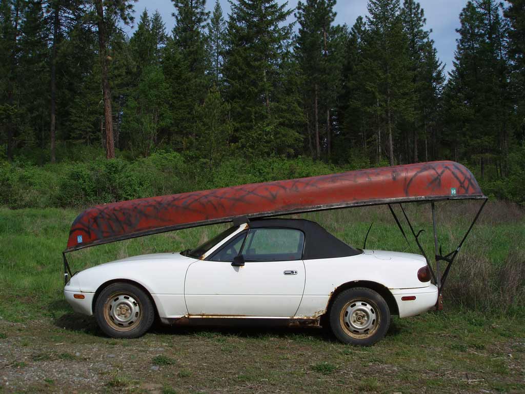

Here is the Miata in it's prime as a MUV. Miata Utility Vehicle.
(IMG:style_emoticons/default/happy11.gif)
