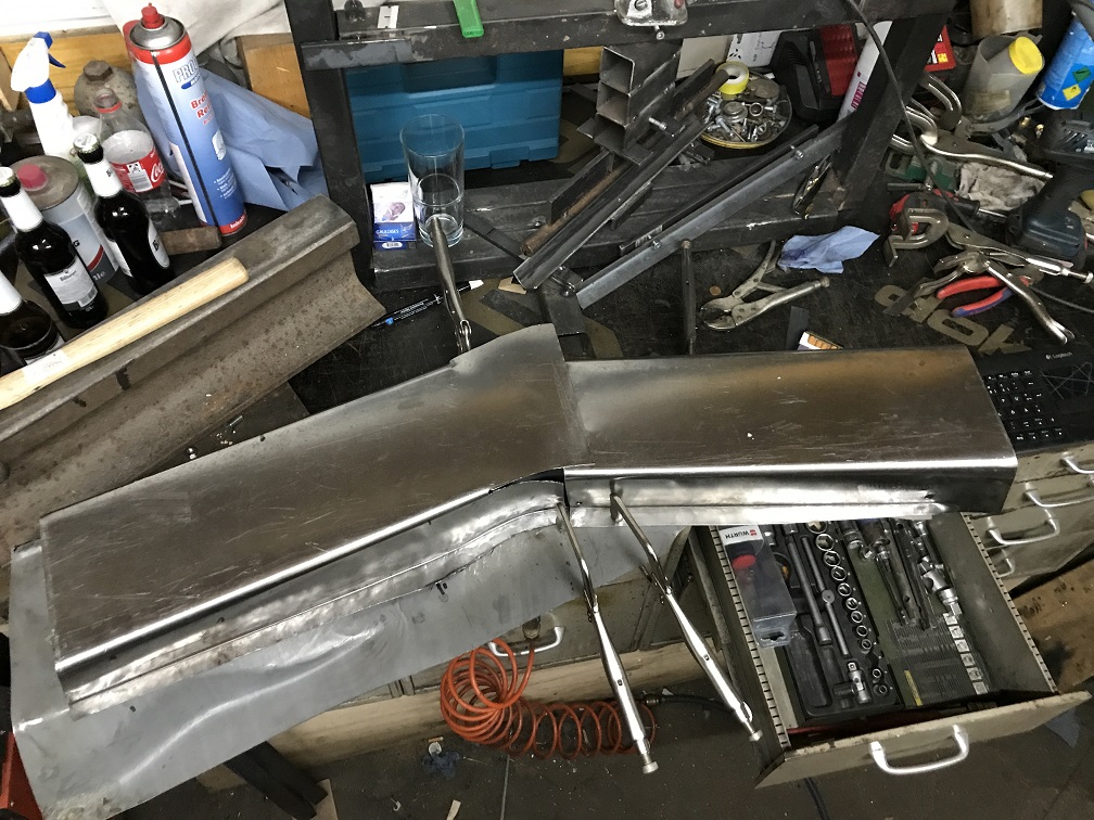

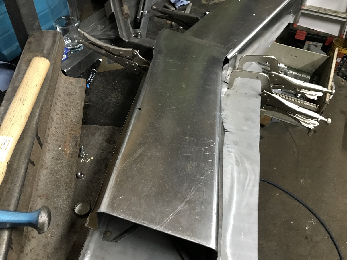

A few posts earlier, you've been talked about the repairpanel of the inner frame section and it bothers you that it's not made like the original which is two layers of steel ...
This bothered me too and I decided to build my own repaipanel. The Panel will be a combination off an own build outer layer and the Restorationdesign repiarpanel as the inner reinforcement layer. This is what I've built so far.
The panel is made from one piece of 1.2mm sheetmetal and fits nearly perfect to the inner wheelhouse repiarpanel. It took me about half a year and 4 tries to make it right. I ended up making my own tools to get the edges properly bended.
Next step is trim the overlap, fill the gaps, fit the inner layer and finaly fit it to the car before welding it in.
If anyone is interested in the building process, I will open a new thread to discribe the process
