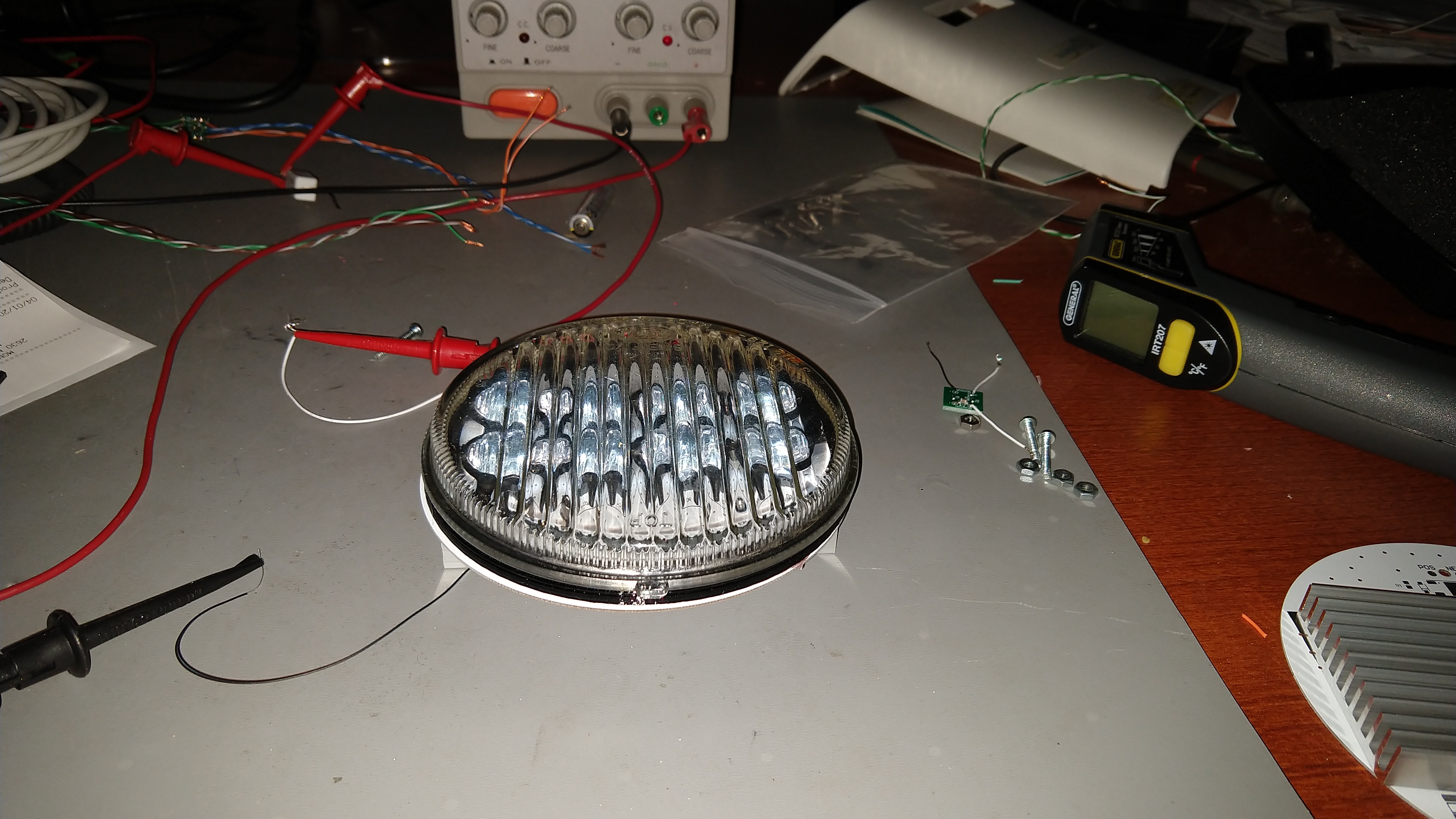

The design of an early foglight LED board has begun. mepstein sent me a couple of foglight fixtures to use to design the board. 2 main issues are fitment and heat dissipation. If things work out ok the design should be able to be re-laid out for the later square foglight.
The board will have 8 Cree XP-G3 high power surface mount LEDs with 350ma current each. These will burn about 1W of power with a total power dissipation expected to be less than 10W. Hopefully these will be almost as bright as a headlight.
Each LED will have its own focusing lens. The lenses are Carclo 10192 elliptical 20mm lenses. The light pattern for the 10192 lens is shown below.

The glass lens fits nicely with the printed spacer. I believe the earlier lenses have a deeper cavity.

Spoke   Have the PCBs in hand. Will assemble the first boa...   Apr 26 2019, 08:01 AM
Spoke   Here's the PCB under the glass. It will be int...   Apr 26 2019, 08:03 AM

Spoke   With the correct settings, the oven worked fine. ...   Apr 29 2019, 03:06 PM
Spoke   All lit up with LED lenses. Won't be able to c...   Apr 29 2019, 03:10 PM

Spoke   Here's the light pattern with 0.5A per LED on ...   Apr 29 2019, 03:43 PM
Spoke   The glass lens fits nicely with the printed spacer...   Apr 29 2019, 03:46 PM
Spoke   Here's the light pattern with 0.5A with the gl...   Apr 29 2019, 03:48 PM

Spoke   The first fully built up PCB. Somehow I managed to...   Apr 30 2019, 04:10 AM
Spoke   Started doing some burn in on the first unit. Will...   Apr 30 2019, 04:15 AM

Spoke   Burned in the prototype for about 20 hours this we...   May 3 2019, 07:59 PM
Spoke   The metal clips will need to be made for each unit...   May 3 2019, 08:01 PM
Spoke   The PCB fits nicely in the case. Will run this for...   May 3 2019, 08:04 PM
