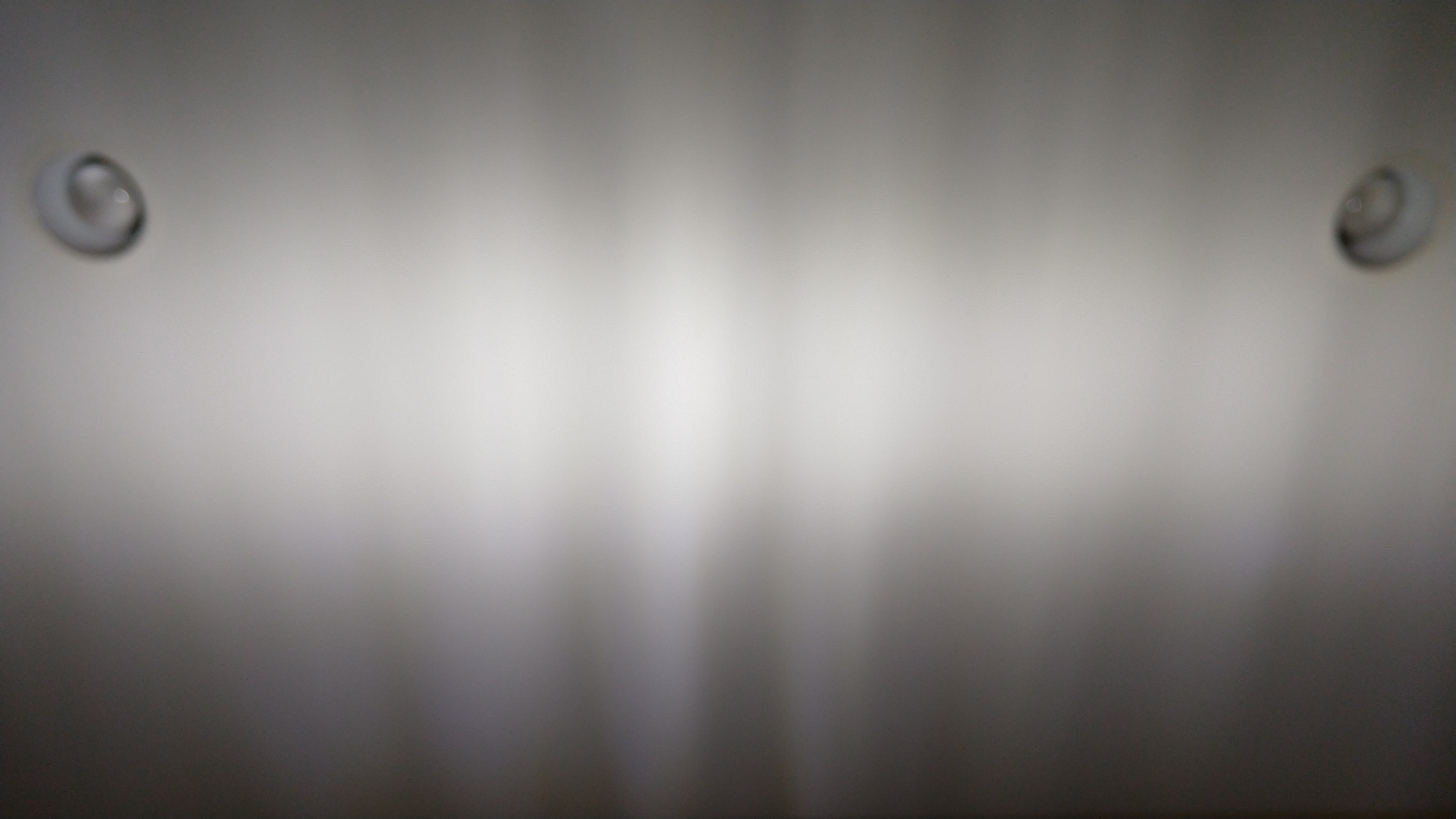

Here's the light pattern with 0.5A with the glass lens. The effect of the glass diffusers can be seen.
As Chi-town mentioned, there will be some loss of light because of the glass diffuser. It seems to be about 15%.
With 0.5A at 1 meter, I measure:
10000 Lux w/o glass
8500 Lux w/glass
At 0.35A at 1 meter:
6000 Lux w/o glass
4500 Lux w/glass
