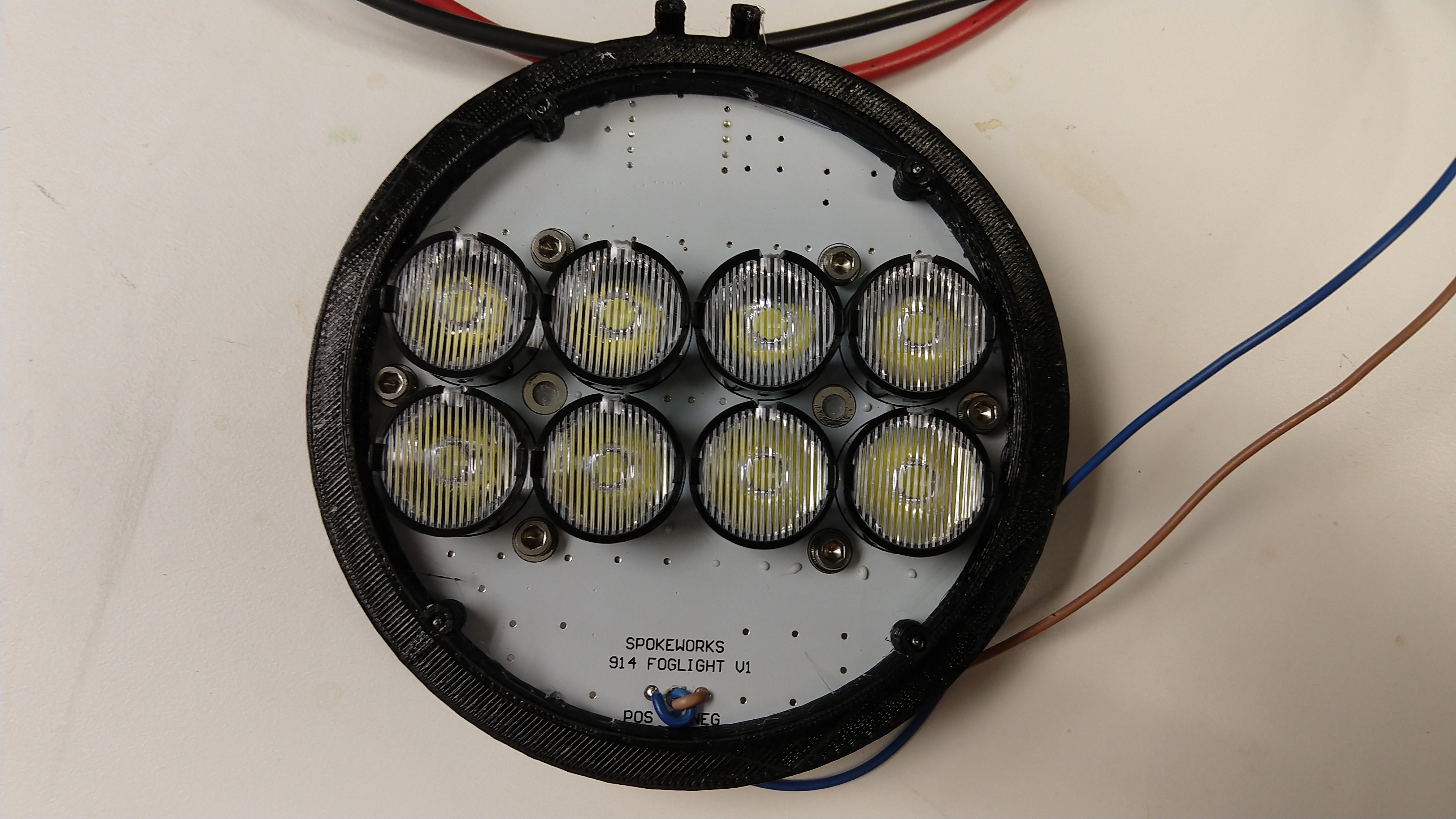

The design of an early foglight LED board has begun. mepstein sent me a couple of foglight fixtures to use to design the board. 2 main issues are fitment and heat dissipation. If things work out ok the design should be able to be re-laid out for the later square foglight.
The board will have 8 Cree XP-G3 high power surface mount LEDs with 350ma current each. These will burn about 1W of power with a total power dissipation expected to be less than 10W. Hopefully these will be almost as bright as a headlight.
Each LED will have its own focusing lens. The lenses are Carclo 10192 elliptical 20mm lenses. The light pattern for the 10192 lens is shown below.

Started doing some burn in on the first unit. Will run this for a couple of days to make sure it works. The LEDs are running 0.5A and the total unit power dissipation is just under 14W or just about 1A at 14V input.
Comparing the light output with the headlights on my '14 328, these are less than 1/2 as bright. The headlights on the 328 measured 19000Lux at 1 meter whereas this unit measured 8700Lux with the glass lens.
From early measurements, it looks like there's about a 40C rise in temperatures over ambient. That's about what I expect. It will be interesting to get this in an enclosure and see what happens.

Spoke   All lit up with LED lenses. Won't be able to c...   Apr 29 2019, 03:10 PM

Spoke   The first fully built up PCB. Somehow I managed to...   Apr 30 2019, 04:10 AM
Spoke   Started doing some burn in on the first unit. Will...   Apr 30 2019, 04:15 AM
