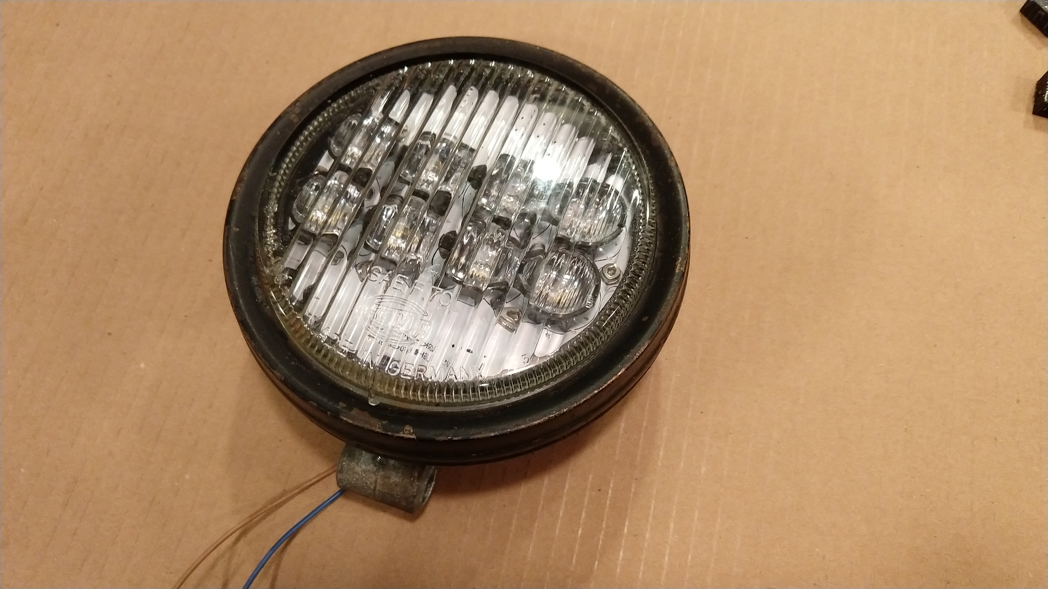

The design of an early foglight LED board has begun. mepstein sent me a couple of foglight fixtures to use to design the board. 2 main issues are fitment and heat dissipation. If things work out ok the design should be able to be re-laid out for the later square foglight.
The board will have 8 Cree XP-G3 high power surface mount LEDs with 350ma current each. These will burn about 1W of power with a total power dissipation expected to be less than 10W. Hopefully these will be almost as bright as a headlight.
Each LED will have its own focusing lens. The lenses are Carclo 10192 elliptical 20mm lenses. The light pattern for the 10192 lens is shown below.

The PCB fits nicely in the case. Will run this for a while to make sure the temperature rise is ok.

Spoke   The PCB fits nicely in the case. Will run this for...   May 3 2019, 08:04 PM

Spoke   Got the prototype lit up in the foglight enclosure...   May 5 2019, 02:13 PM
Spoke   Compared the output of the LED foglight to the fog...   May 6 2019, 09:52 PM
Spoke   The driver side foglight is covered up and the LED...   May 6 2019, 09:57 PM
