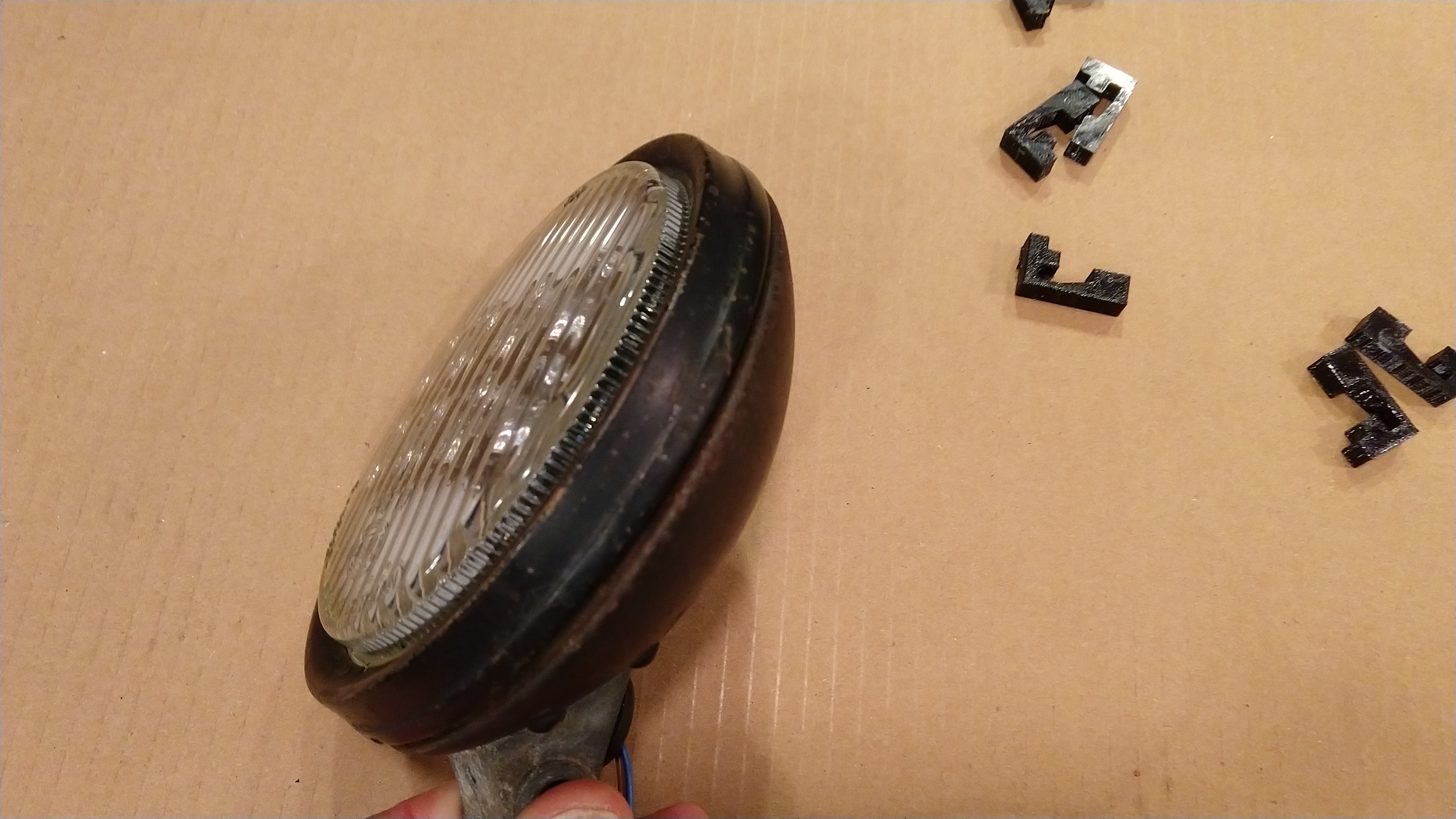

Spoke   The metal clips will need to be made for each unit...   May 3 2019, 08:01 PM
Spoke   The PCB fits nicely in the case. Will run this for...   May 3 2019, 08:04 PM
Spoke   Not sure how to connect up to the existing wires y...   May 3 2019, 08:07 PM
