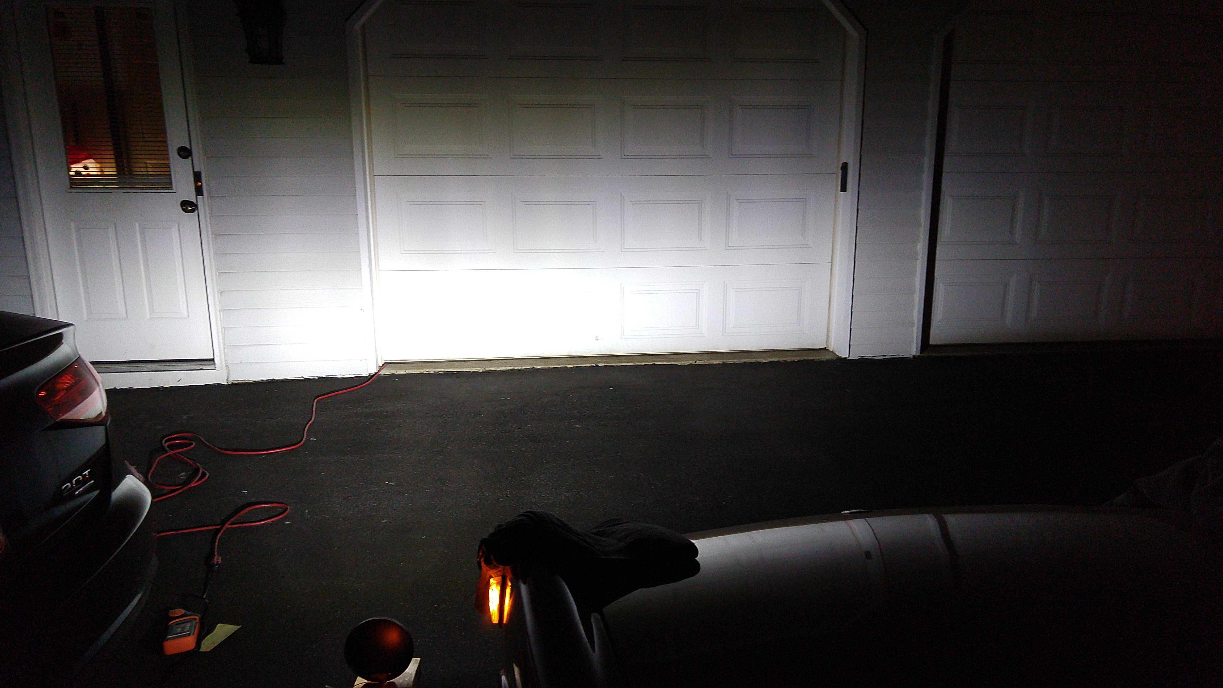

The driver side foglight is covered up and the LED foglight is lit up right next to the car. The LED does not have a sharp cutoff and the additional intensity of the LED washes out the tight cutoff of the passenger side foglight.
At 1 meter, here are the measurements of the lamps:
914 Foglight: 1800 Lux
LED Foglight: 5500 Lux
The LED foglight is 3x brighter than the standard foglight on my '71 although the upper cutoff is not as sharp with the LED as the standard foglight. The LED may need to be adjusted a bit lower to not be too bright to oncoming drivers.
