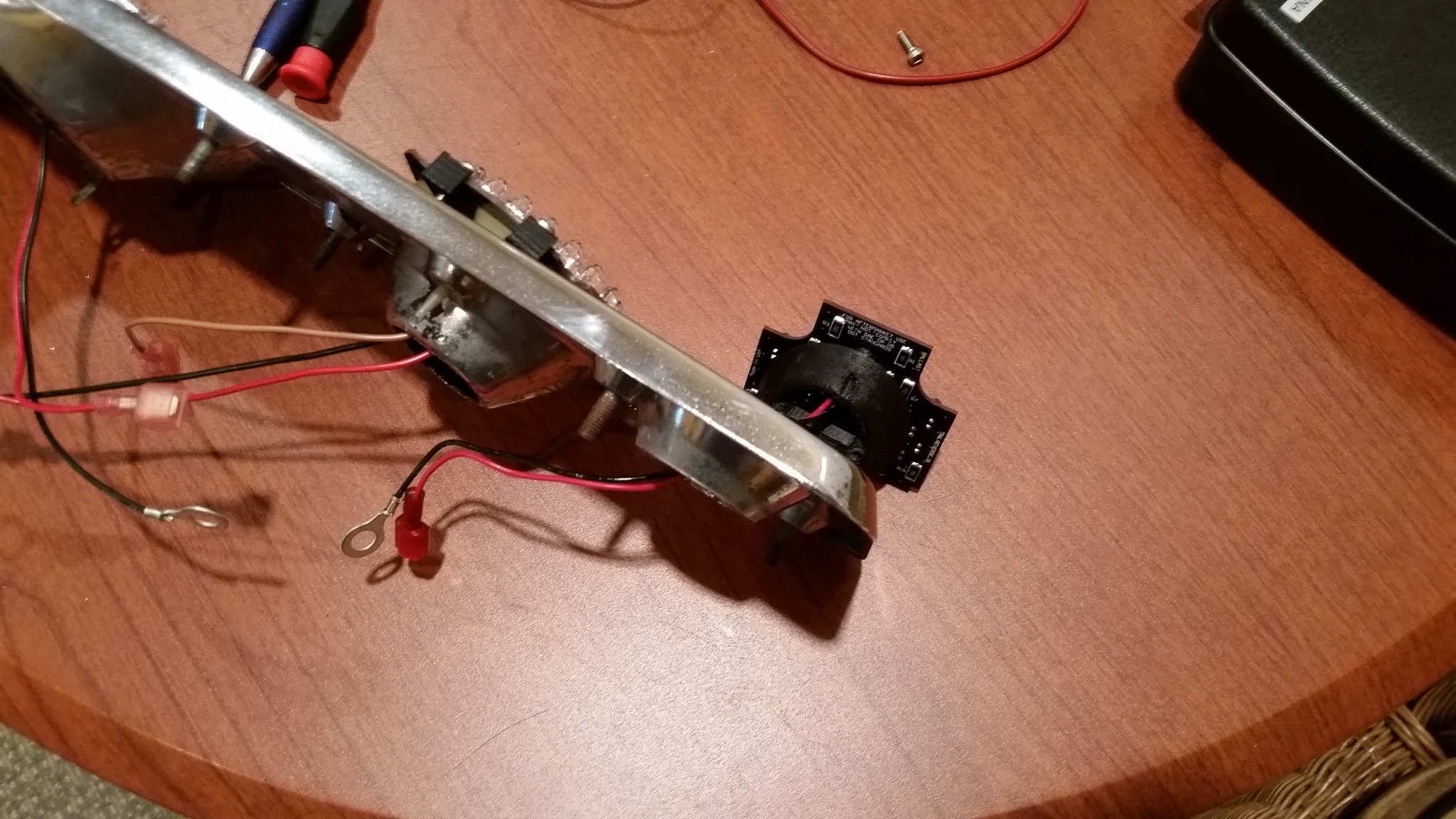

Open the housing and disconnect the wires! No cutting allowed!
Spoke
post May 8 2019, 08:02 PM
Jerry
Posts: 7,429
Joined: 29-October 04
From: Allentown, PA
Member No.: 3,031
QUOTE(JeffBowlsby @ May 7 2019, 08:55 PM) *
Agreed. My LED boards are designed to be plug'n'play without cutting the vehicle wiring using the existing bulb plug to power the LEDs. An exception to that are the Triumph Spitfire and TR6 where the bulb sockets are so unreliable that LED boards connect directly to the wire loom bypassing the bulb socket.
For the 914 foglight, there's not much play in the wiring at the foglight fixture. I didn't think there was a connector for the the fogs inside the trunk. One issue is the condition of the ground spade connector. The one foglight fixture from Mark the ground spade was rusted onto the lug on the fixture. For the foglight the original bulb socket will not be used as the reflector and bulb socket are not used with the LEDs.
I'll make it work with the existing wires.
