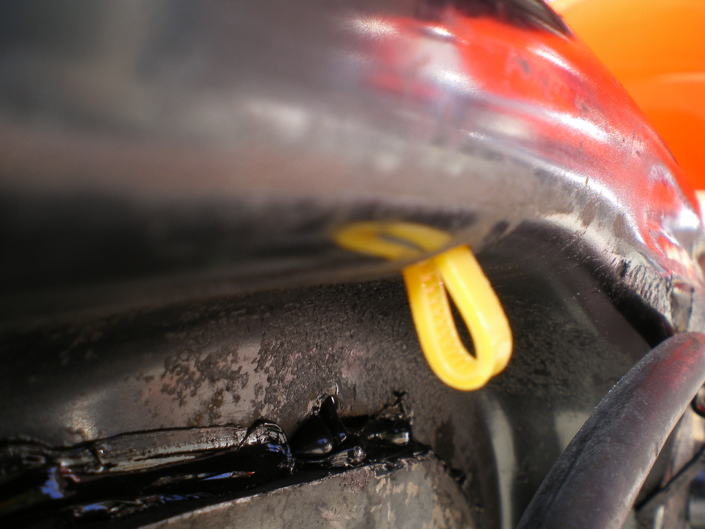

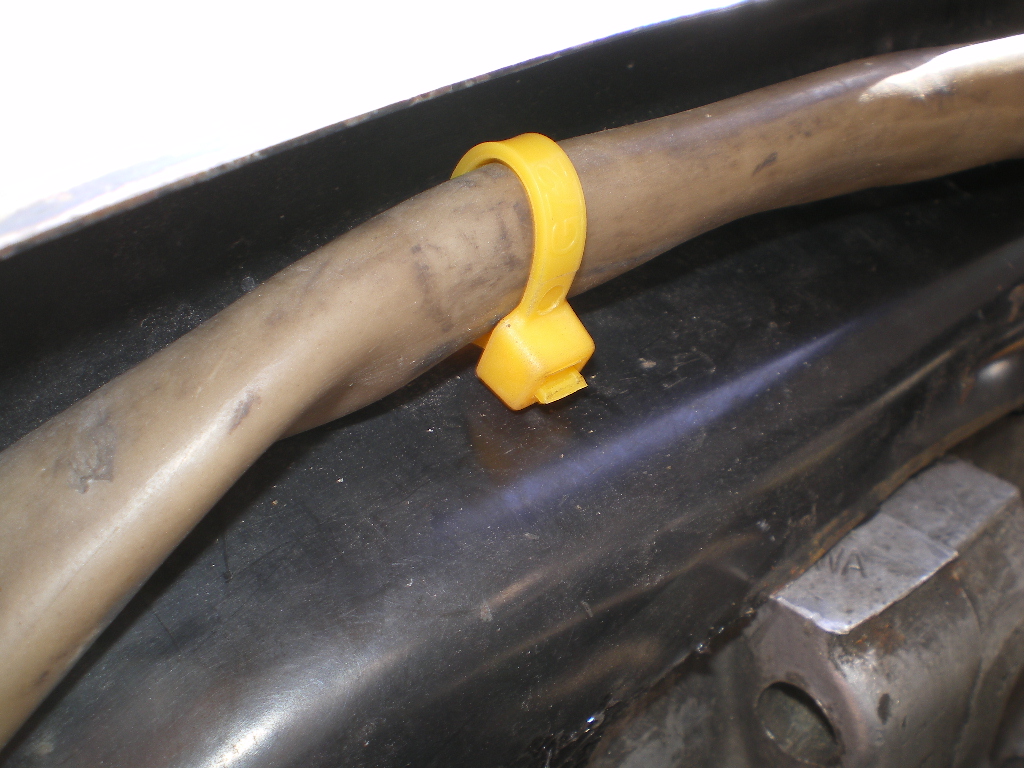

IIRC, there is/are 1 or 2 small holes in that big rear tin that an OEM plastic clip attached to and thusly held the wire off trans. Don't want that cable rubbing anywhere! (IMG:style_emoticons/default/beerchug.gif)
EDIT: I went back and found these pics. I couldn't or didn't locate the OEM clip. You can do this with a wider zip tie. Pics show both sides. No it doesn't pull through if you use a wide (^mm?) zip tie.
