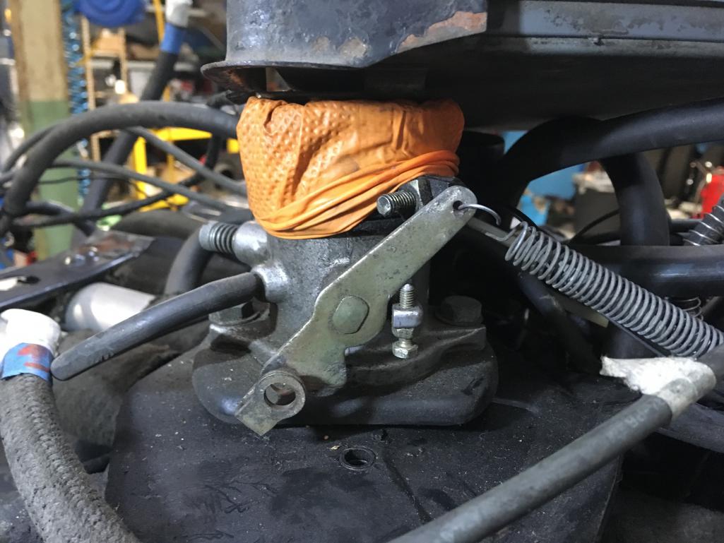

CheeRS   Was surprised to found this modification on my eng...   May 18 2019, 02:39 PM
CheeRS   this screw is not original. Why make this ? Perhap...   May 18 2019, 02:43 PM
billh1963   I've seen a picture like that before... <_...   May 18 2019, 03:14 PM
