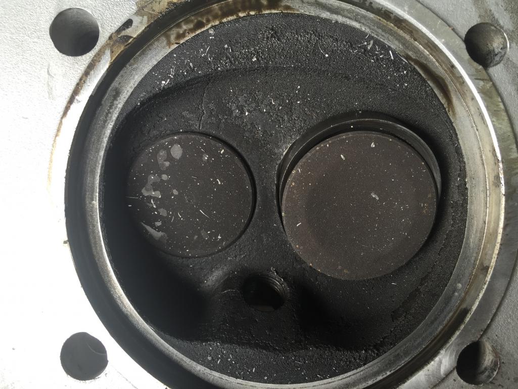

two weeks ago I was in Monthlery near Paris France, for a wagenfest with my 914.
Get some troubles with the engine, a hammer noise and the engine stopped smoothly like out of gas.
here is what I found :

I've seen a picture like that before... (IMG:style_emoticons/default/dry.gif)
Before my valve seat dropped I noticed my temperatures were running hotter than normal. Once I pulled the engine I noticed the thermostat had failed...and it failed closed! Yes, someone in the past used a the Mexican made type I thermostat that fails closed

914_teener   classic dropped valve seat. Pull the heads and re...   May 10 2019, 01:30 PM

GregAmy   I'd be more worried about the dropped valve se...   May 10 2019, 06:00 PM
CheeRS   I'd be more worried about the dropped valve s...   May 11 2019, 12:42 AM
bandjoey   For a guy with that shop, I don't think he wor...   May 10 2019, 06:11 PM
Chi-town   Have the head checked for cracks before you waste ...   May 10 2019, 07:02 PM

Bleyseng   If I were you I'd order a set of new castings ...   May 11 2019, 08:43 AM

porschetub   I would be rather worried about rebuilding those h...   May 11 2019, 11:58 PM

billh1963   I've seen a picture like that before... <_...   May 18 2019, 03:14 PM
