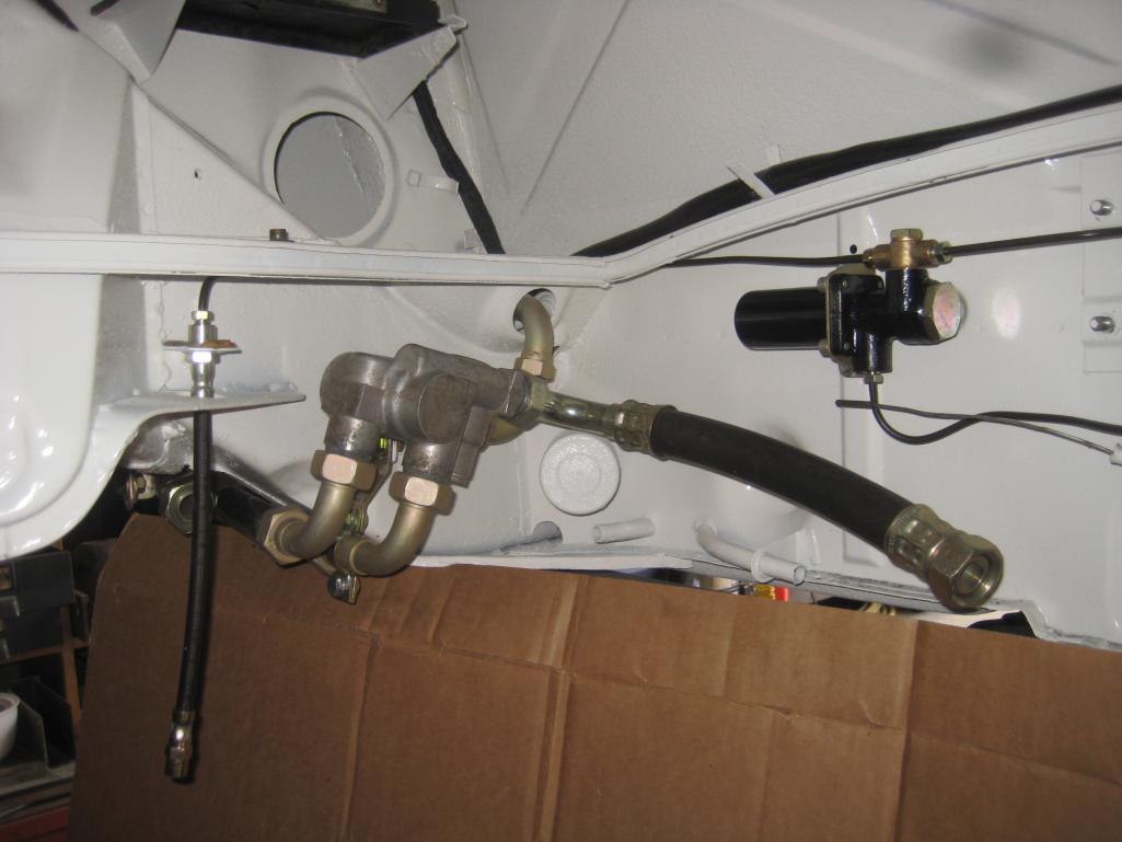

I have decided to place my thermostat in the front trunk. I think it is easier for me to do that. I am routing the oil lines back to the engine compartment. Here are a few pics of my current set up on my 3.2. I could use some help plumbing the new oil lines back to the engine and oil tank. Can you tell me how to connect the new oil lines to the current oil lines please.
Here is the line from the bottom of engine to the oil tank. Here is the oil line from the tank. I am not sure where it goes. Here is another picture of this line that has the oil removal plug. I didn't picture the other oil line on top of the oil tank that I thinks goes to the cooler on the engine. So I am looking if I can use any of these lines in conjunction with the two oil lines coming back to the engine compartment on the drivers side. Thanks, Buck |

This is a decent picture but pbase has more pictures of the real setup.

mb911 Are you asking what line connects to the oil coole... May 15 2019, 07:03 PM
sixnotfour the one with the drain T is the direct supply to t... May 22 2019, 02:55 PM

This is a decent picture but pbase has more pict... May 23 2019, 05:27 AM
sixnotfour
Is why I worded my reply the way I did....
Yes R... May 23 2019, 09:30 AM![]() ![]() |
