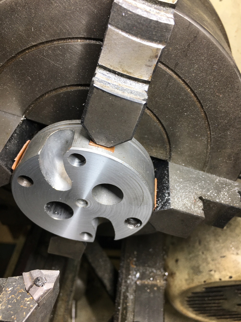

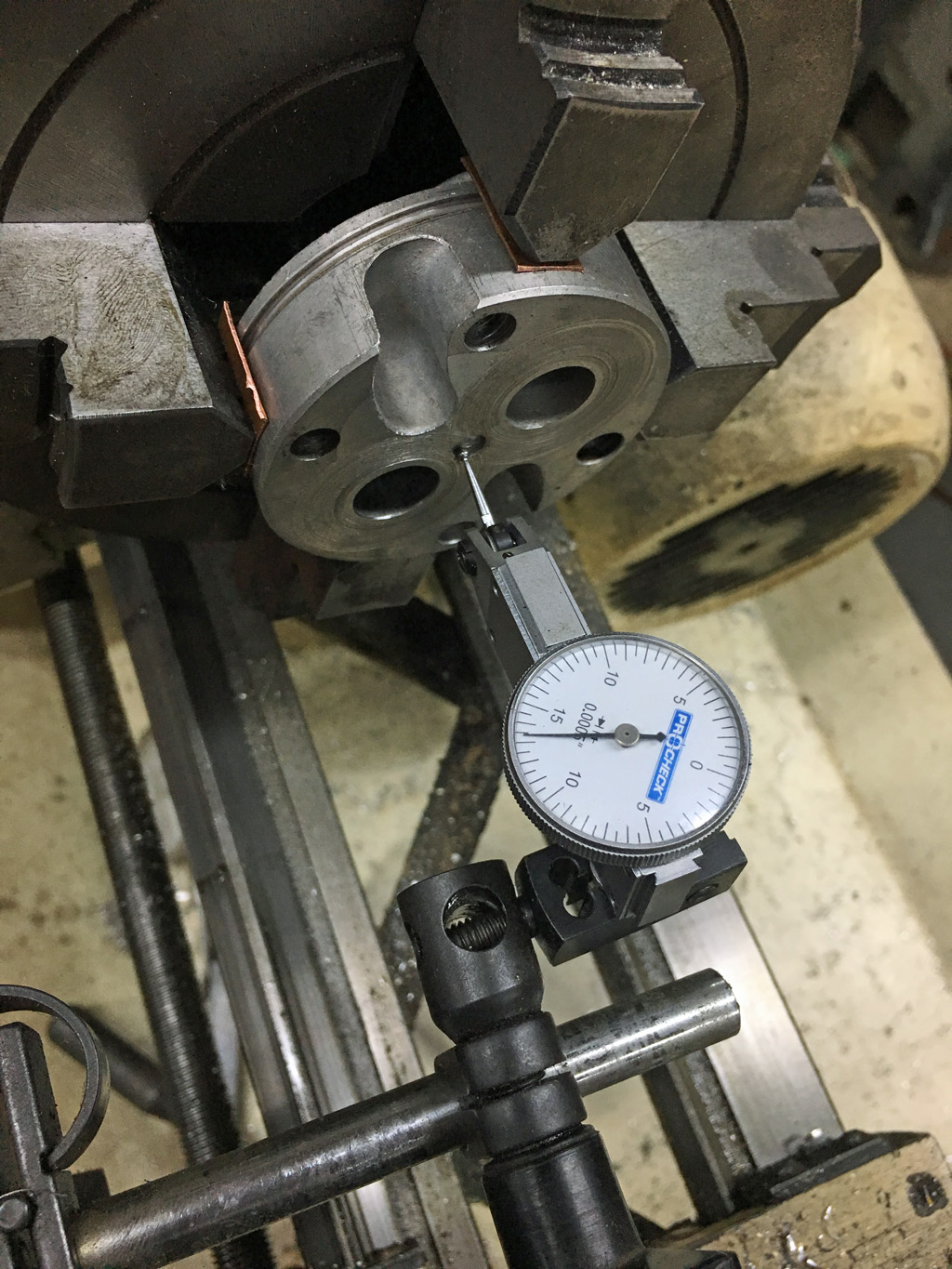

I decided to start with my original pump inner housing since that was in better shape.
On the original it had some light scoring and the stationary shaft had been pushed out toward the cam and actually had been lightly brushing the cam bolts.
No harm in messing with this one. Disassembled for machine work.
Setup in the lathe for a light skim cut.
The idea here was to just do a light skim cut of 0.001 - 0.002" to clean up the scoring.
