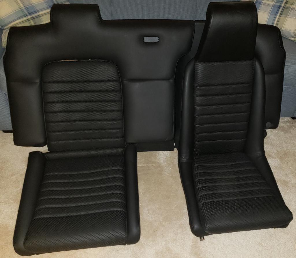

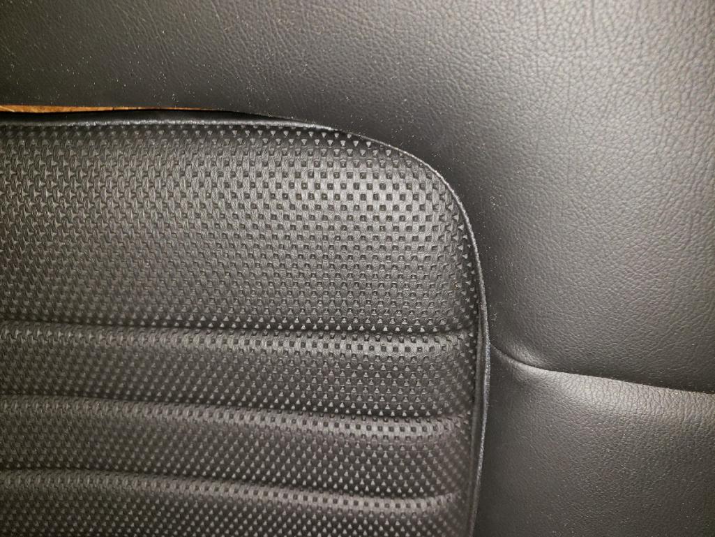

Sorry I have not posted as much as I would like to. Here is the interior that Bill had done...very well done!
