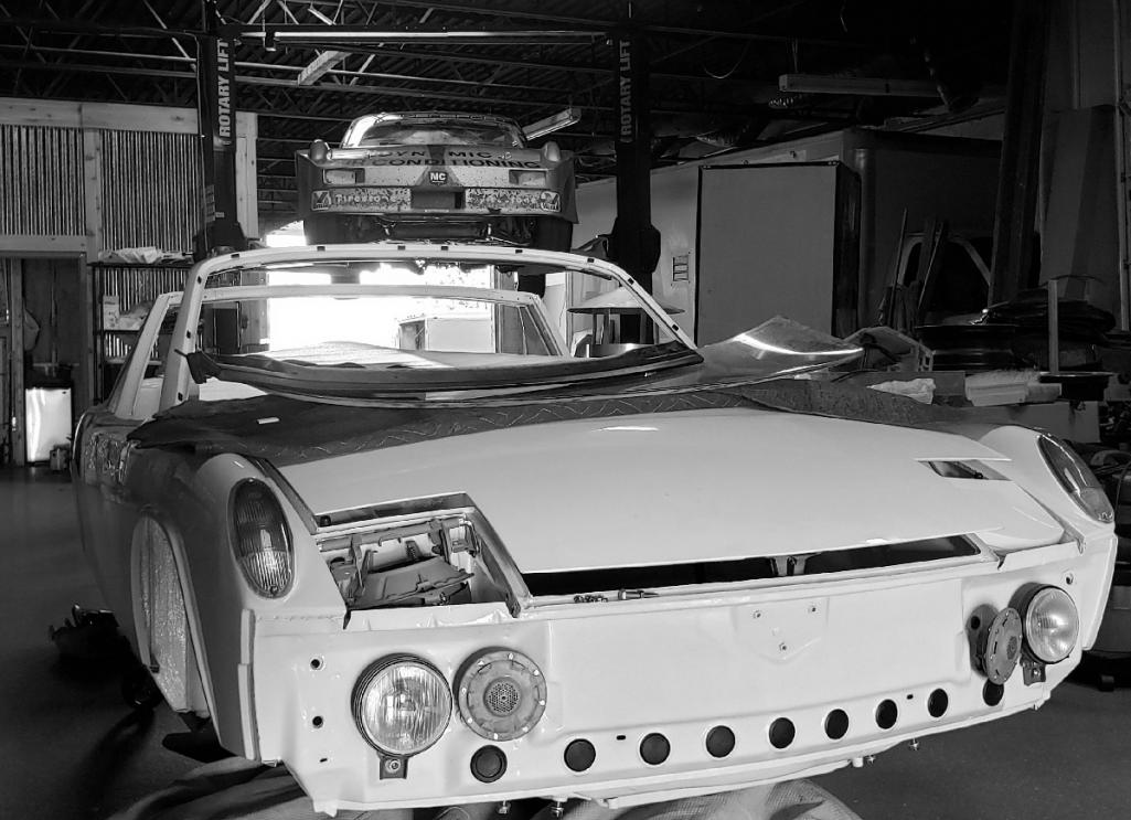

gms   Sorry I have not posted as much as I would like to...   May 28 2019, 08:39 AM
gms   Artsy pic   May 28 2019, 08:41 AM
